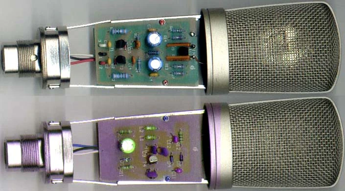

I once had pics of the 1006 circuit board (can't find them now) and it looked just like the 2003. Here's a picture of a modified 2003. Does it look like your 1006?

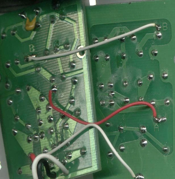

No, it looks pretty different. Here, I scanned it in.
I don't know how this picture thing works...

Different board, but probably similar circuit. Actually from looking at the board, the 1006 looks just like the 603s circuit. If you take the top board off, there should be a cap on the back of it on the end closest to the capsule. That's the most important one to change. Can you post a pic of the back of the board so I can be sure?
I did this too. It's the same board as the MXL v63 and the MCA SP1. Change the one on the back of the board to a 1000pF polystyrene. Change the two little ones on the outer edges (marked 224) for .22uF Mylars and the two bottom ones (by the white red and black wires - marked 223) for.022uF Mylars. The .22uF are big, so you may want to put 'em on the backside. I left alot of the leads out so I could move them to a position that would tilt so I could get the body on. On the MCAs I wanted a little more low end, so I changed the .022uF to .047uF. It seemed to make the bottom a little bigger.
That cap is marked 102, so I guess it's 1000pf.
