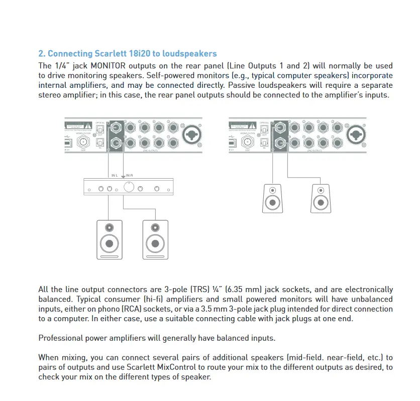

From the manual...
G
That is a useful feature of the AI I was unaware of Sasquatch, is the switching simple? Maybe can be set as a keyboard shortcut?
Software settings are rarely as convenient as a hardware button and I for one like having an alalogue pot on my main speaker feed!
