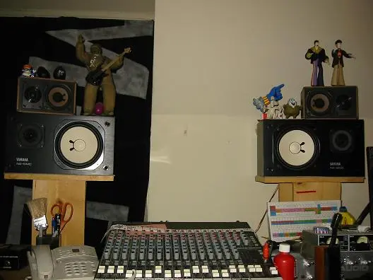

im setting up some samll stereo speakers for a/b purposes.
i want the stereo speakers on their side, with the reference monitors on top.
question is, does the tweater stay on the inside or the outside?

Tweeters are generally placed on the outside, like so.....

Funny that you should ask this today. I'm using a pair of NS10s with the tweeters on the "outside" as per MadAudios' set up but last night I was watching a doco called The Voice.....when they interviewed Trevor Horne you could plainly see his NS10s set up with the tweeters on the "inside". Perhaps it's horses for courses.
I too have seen plenty of pic's with tweeters in.
I have a set of tannoys with tweeters in. I only use them for the "less than perfect stereo test" since they are celing mounted. Otherwise I prefer my monitors vertical.
F.S.
I keep the tweeters "in" on mine to avoid having the highs pass thru the woofer's pressure wave (around the crossover point and below).
Sounds a little clearer to me, although it's probably just my imagination.
I talked to a Klein & Hummel guy last year who was telling me that any 2-way speaker should NEVER be placed horizontally as it creates phase issues at, and around, the crossover point. Makes sense to me really, especially when you consider cross-over frequencies & wavelengths and then look at the distance from tweeter-to-woofer...
