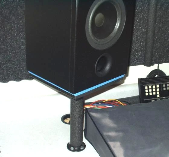

If you’re mounting your monitors on floor stands, decoupling with a pad will have little impact. If you have these sitting on your desk or console, then yes… good idea to decouple.
Many of the commercially available monitor pads are made of the same foam as mouse pads. You will need about 2” worth of mouse pads to justify your time and trouble.
A better option is to buy a camping pad at Wall-Mart or another discount chain for a few dollars. If you’re not into camping these pads are used to put on the ground under sleeping bags for comfort and thermal insulation from the ground. The kind I’m talking about are less than $5.00 at Wal-Mart. You can spend a little more for thicker and more comfy pads -- still less than speaker pads from a music store.
They are easily cut with scissors. Cut to fit the bottom of the monitor and double the thickness using two pieces for each monitor.
My decoupling system is a little more elaborate. I have stands I made from steel pipe and fittings permanently mounted to my tabletop. They are insulated with rubber and minimal contact where they mount to the table, and where they mount to the speaker rest, as well as having a pad between the rest and the speaker.
~Tim
