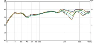

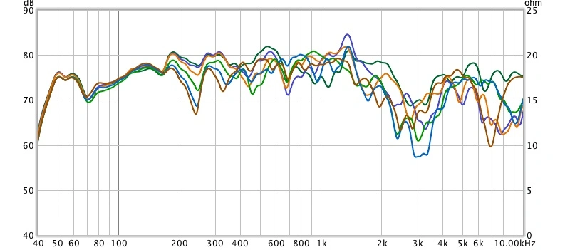

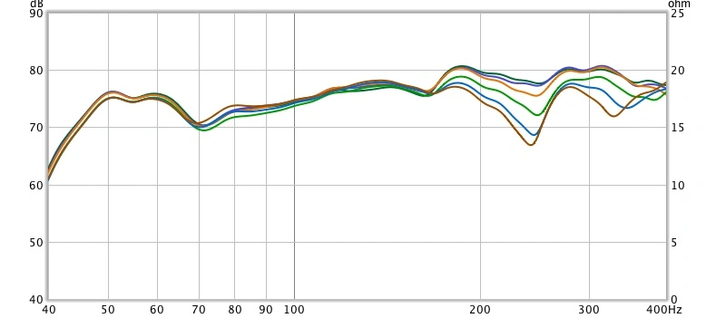

It's funny because this can make an important difference in what you actually hear. I started playing around with the height of my monitors by raising them in two inch increments from 42" to 54." I then measured the frequency response after each change (see attached REW plots).
After that I measured myself (6'4") and my chair height (18"). Then I went shopping for an adjustable seat and something to stunt my growth.

What does each of the graphs represent?
The graphs represent frequency response with FR on the horizontal axis and level on the vertical. The first, shows the FR from 40 to 10k (full spectrum more or less). The second, a detailed look at the low frequencies (40-400hz). The colors represent the various measurements. In this case, speaker height changes (42" to 54").
They show quite a bit of variation depending on how high the speakers are raised. This is particularly true above 200hz.
This is because you're changing their distance to the floor and ceiling...and their interaction with the room.
Generally, you want to get the midpoint between tweeter and speaker at your seated ear height. Some people like them up an inch or down an inch...some up but tilted down an inch...etc.
I wouldn't get to hung up on your graphs...because those were done with a stationary mic. When you mix/listen, your head is always moving, so the 2" increments are going to be happening constantly when your move you head around.
If you have a low ceiling...like a typical home room with 8' ceilings...you kinda want the speakers to end up generally in the 2/3 height from floor.
You don't want them up much closer than that to the ceiling.
