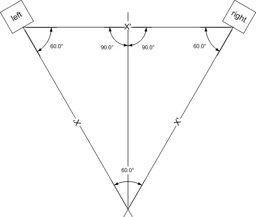

Yes, 30 degrees is the ideal, rule of thumb starting point. This way the distance between the monitors, and each monitor and your ears, is identical.
This forms an equilateral triangle - all corner anges are 60 degrees, and all lengths of the triangle are are identical per this attached diagram.
