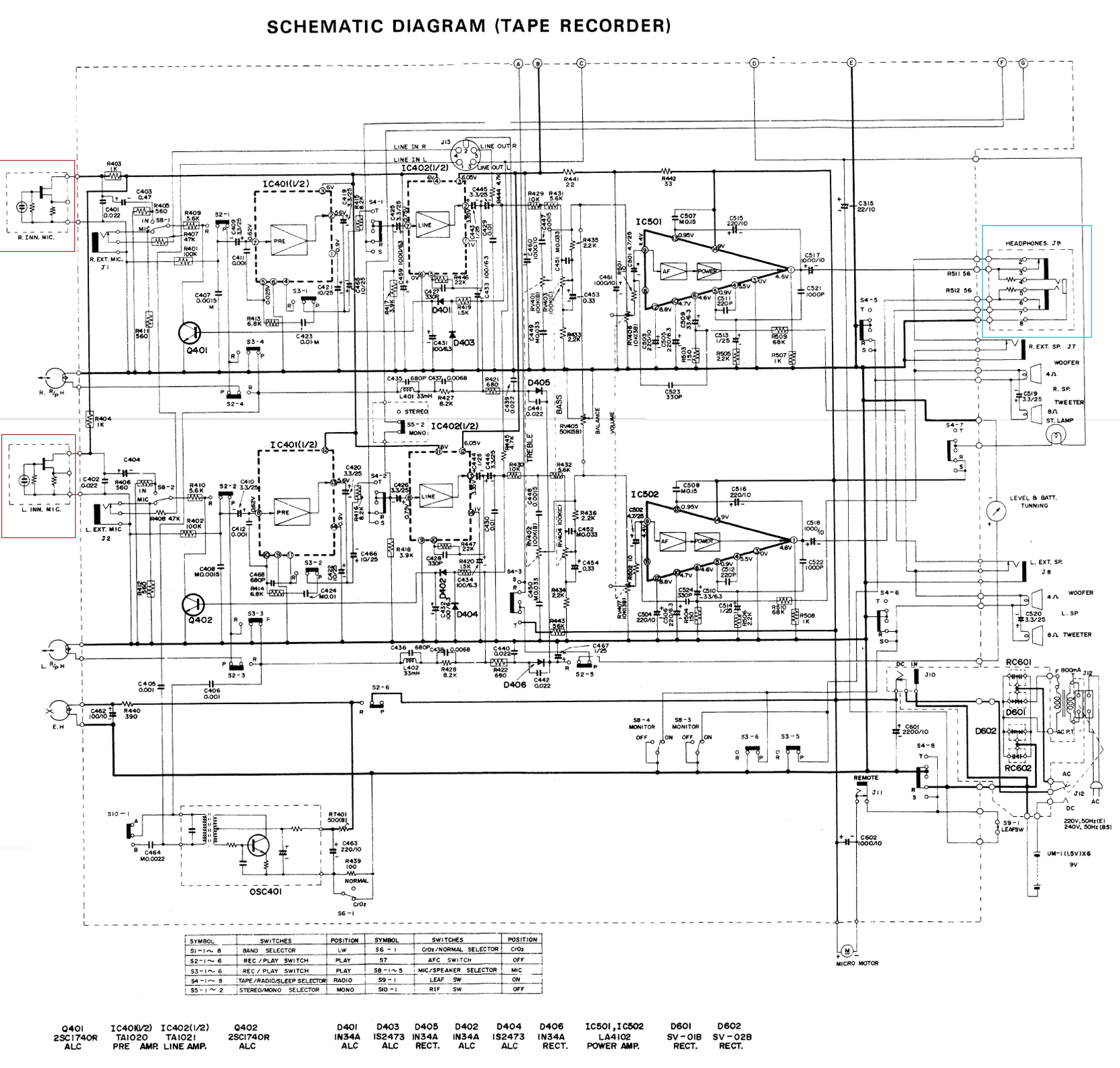

Here is the schematic diagram, you can view it in a bigger version if you open it in a new window
can someone see if the headphone amp takes i´ts signal from the record head?
I marked the inner mic´s with a red square and the headphone out with a blue square, i cannot find the heads though??
The headphone out does not come "off" or "thru" the head. The head is designated in the diagram with the little circle thing with the arrow, as R/P-H (record/play head), right and left, respectively.
From what I see in my minimally competent view of schematics, is that the R/P head gets a practially raw and unamplified signal from the internal mics, then the signal is split and amplifed to the Line Outs (DIN connector) and further amplified again to the Headphone Out.
Maybe you could tap the signal off the pins 2/3 (L) and 2/5 (R) of the DIN connector, which is off the LINE amp, and bypasses the Headphone amp entirely.

So, from what I can tell by your reply I could aswell use the output (DIN) to monitor the internal mics?`

Not quite. the r/p head gets record signal from the amp labeled "line" after passing through the record equalization network. The play back route is shown on the schematic.
Looks to me like you can monitor the mics after amplification at the DIN connector. Pin 5 line out R, pin 3 line out L, and rtn on pin 2.
Try that and dont engage any tape transport functions, that might eliminate some of the noise you are getting.
*EDIT: the machine will have to be set to record to monitor the internal mikes the way I described. Im with A REEL PERSON, open it up and disconnect the motor...
Thank you.
Ok, yeah I see that now, which I didn't recognize before. The switch that designates P or R, just before the head, changes the signal path considerably. When in R it taps of the line amp, when in P it feeds forward to the line amp. That would make sense.

mdainst, do you think I can monitor the internal mics with the DIN connector? You see, there is also an option to connect an external microphone. Maybe its that signal that could be monitored without the tape transport functions going?

Yes. the switch on the back needs to be up for INT mic, and the record button has to be depressed. then you can monitor on the din using the pins I called out in my earlier post.
I get it now! The DIN would give a cleaner sound since the headphone amp is bypassed,, but are you sure the inner mic will be monitored there?
