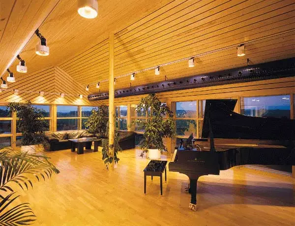

and interesting that "you" say that the drums shouldn't be too close to the walls, i never had the choise, in my tiny bedroom, i had drums in a corner....
but now i've spent alot of time moving fourniture out of my room so i can allmost put them where i want
so where is the PERFECT spot to put drums so i get that COMMERCIAL SOUND ? :D
right in the middle of the room? with the kick-hole looking at a wall or at a corner?
and to make up for putting my drums in a corner: i also put one basstrap in that corner...hehe...for now...
