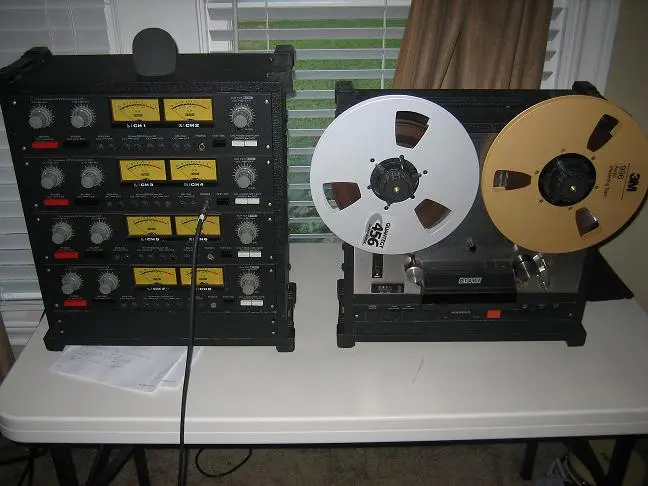

Here is a pic of the tape recorder. There are four different headphone jacks on the front (where the cable is plugged in). One for each pair of tracks. So, the only way I can play them all back together is with the mixer using the xlr outs on the back. But I guess I could listen to them all separately from the headphone jacks.
Anyway, I did notice a hiss buildup while I was tracking/overdubbing. I noticed it got louder each time. After recording six tracks or so, it had gotten pretty annoying. It's not terrible, but it definitely needs to be brought down considerably. I like the character of a little hiss, but I don't want it to be as loud as the freaking guitars. So... it sounds like I need to possibly purchase a noise gate or two for tracking? (only recording one instrument at a time) and then use them again for the two track mixdown? I think i got that right.

I doubt you need noise reduction. I've never used that specific model before, but my 5050 has no real problem with that, and the NR units that would actaully make a huge difference I've heard aren't easy to install and cost A LOT! But don't take my word for it.
Thanks for the kind words. Yeah I really like this recorder. When I clean up the hiss a little, I'm going to be pretty happy. Then I'll have to start shelling out cash for outboard gear. Always something else, you know.
Nice looking rig. That Otari shouldn’t be overly hissy. Minimizing hiss without noise reduction involves operating level, bias and maintenance – cleaning and degaussing. Have you had the machine calibrated?

Yeah, thanks for the responses again. Beck, I did have the machine calibrated before I started recording with it. It cost me a lot. It seemed close to impossible trying to find someone here in Austin who would even do it. I just didn't want to mess with trying to do it myself, because I knew I might go insane. Recording on tape is new to me, let alone calibrating a machine. So I shelled out some cash.
Anyway, I'm starting to think that it is the mixer that needs to be cleaned up... because, when I first got the otari back from the shop I recorded a couple of guitar tracks (this was before I had received my mixing board)... and they turned out sounding really clean with not a lot of hiss.
So after hearing everyone say that the otari shouldn't be the problem, I went back and listened to those guitar tracks and they do sound a lot cleaner (almost no hiss) because I wasn't going through the board. So.... I think I need to get the board cleaned up. Any advice on that situation? Some of the faders (lower tracks 1-4 or whatever) are scratchy when I move them up and down. Right now I'm just using other mixer channels that sound fine.
The person who sold it to me actually told me it would need to be cleaned, because it had some "low level hum on the outputs". Always maintenance with this old equipment.
