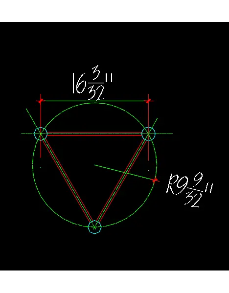

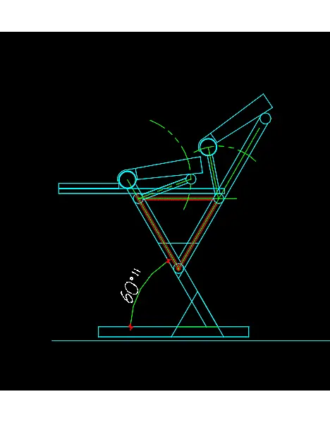

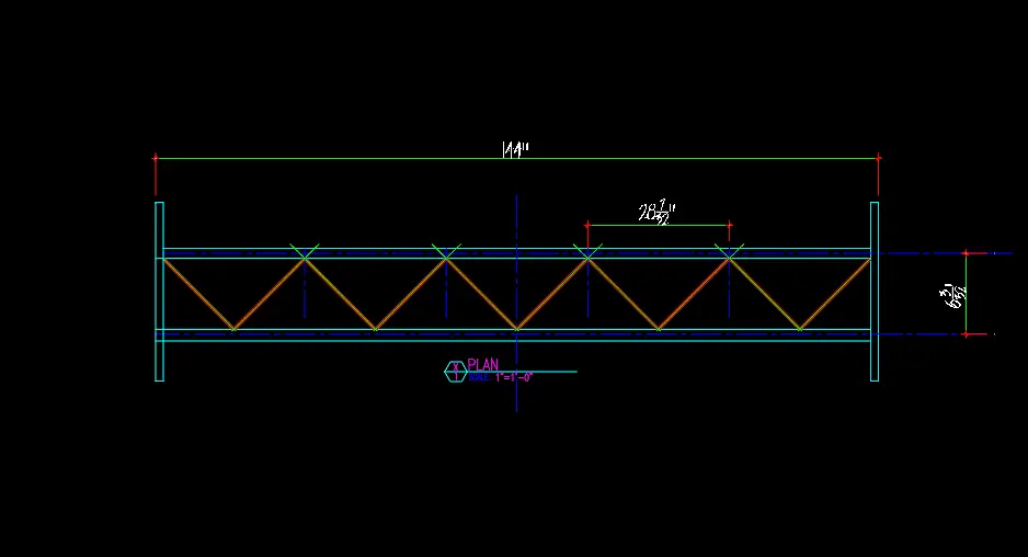

Hey guys....heres the plan. Span 144" clear with a 3D truss. 2" exhaust pipe :D(or .09" wall?), truss diagonals out of 1/2" pipe(conduit) welded to the 2" chords. Weld up 1 1/2"x 2"(1/8" wall) end frames as shown. Weld 1"x1" wrist pad supports @ 24"oc. Weld pivots for support brackets however is easiest. This is per Frederics original plan and Vertical section design. Well, what do ya think, will it fly:p

Here is a plan view, of each side of the truss.

Here is the vertical section of the truss.

Then fasten a wood or sheetmetal cover on the front face of the truss. Use the truss as a cable trough. Suspend another pipe or weld it in the center of the truss for tie off. BTW, the big pipes are 3"d lightwall, just to support the mixers. They can be welded at the ends, or the bottom one welded to the wrist supports. OR>...weld up assembly brackets for bolts and nuts for assembly in the studio. What ever works. If you like it frederic, I'd be happy to detail it down to the bolt. Anyway, an exercise in drawing is all it is.
fitZ:)

Rick - thanks for the designs... no need to go to the bolt level just yet, I think I figured out how to do the center section, since it will be different than the two sides, and the TMD1000's will be on the wings iwth this new design. I'll sketch it this week, scan it, and uploade it to illustrate the idea.
