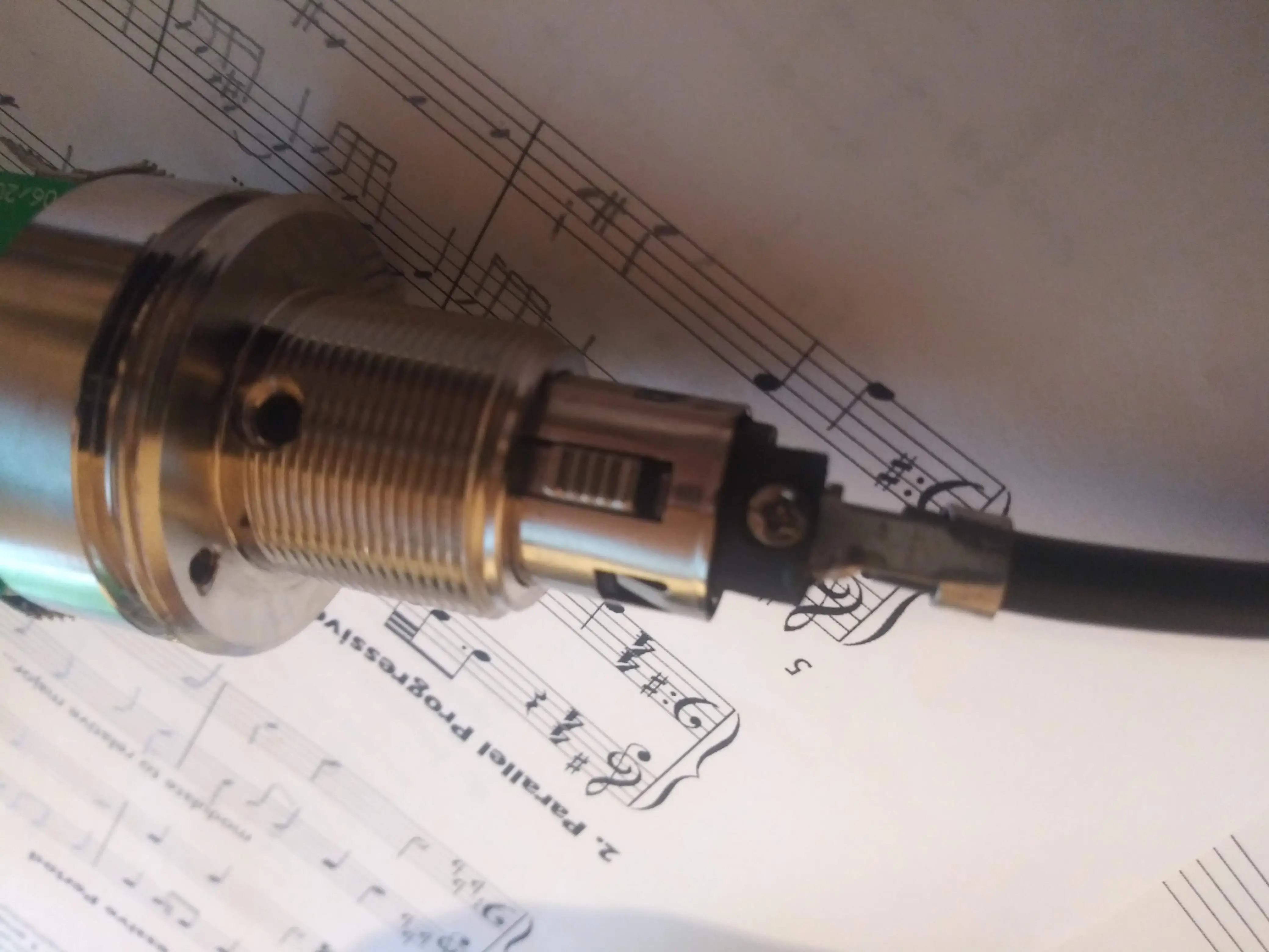

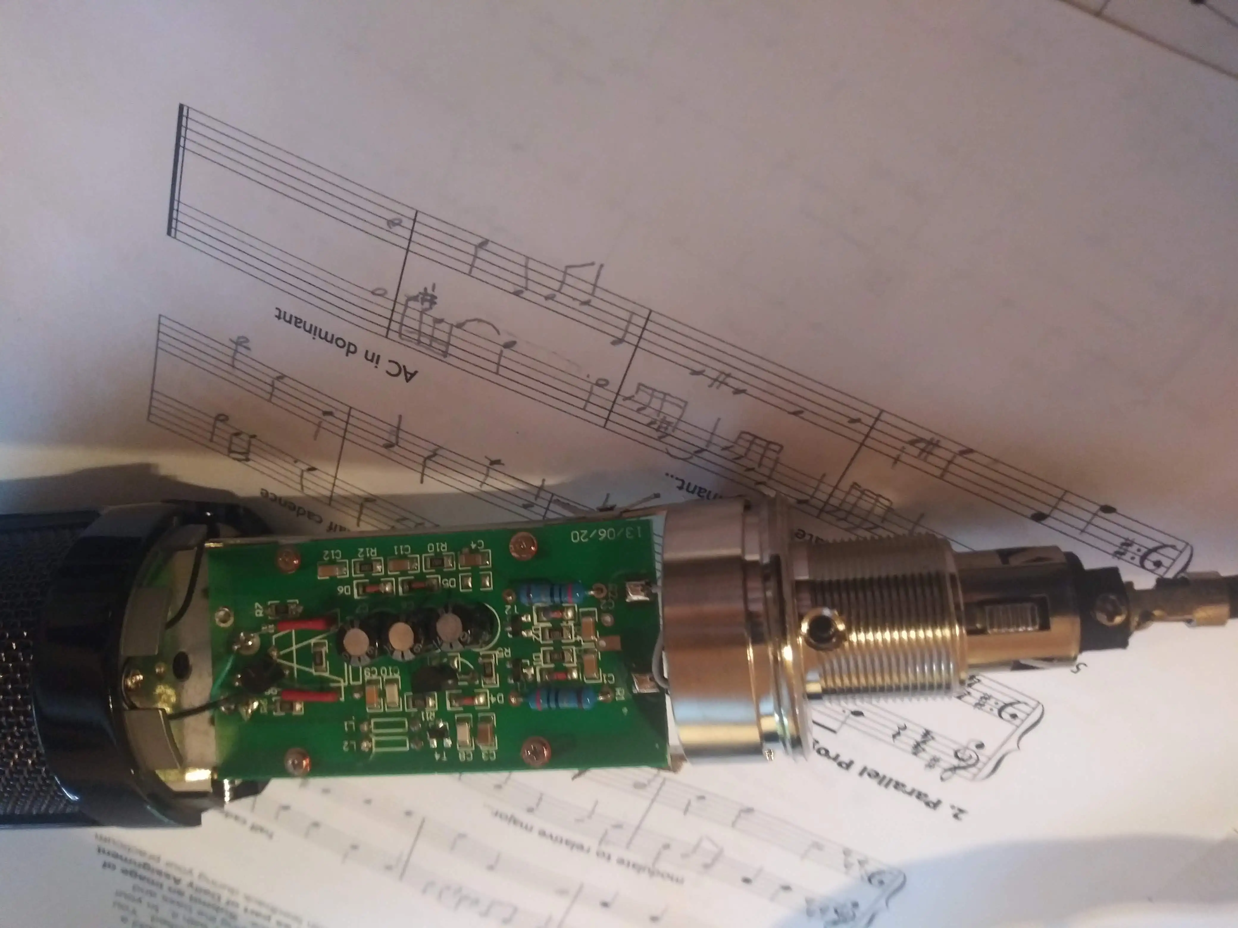

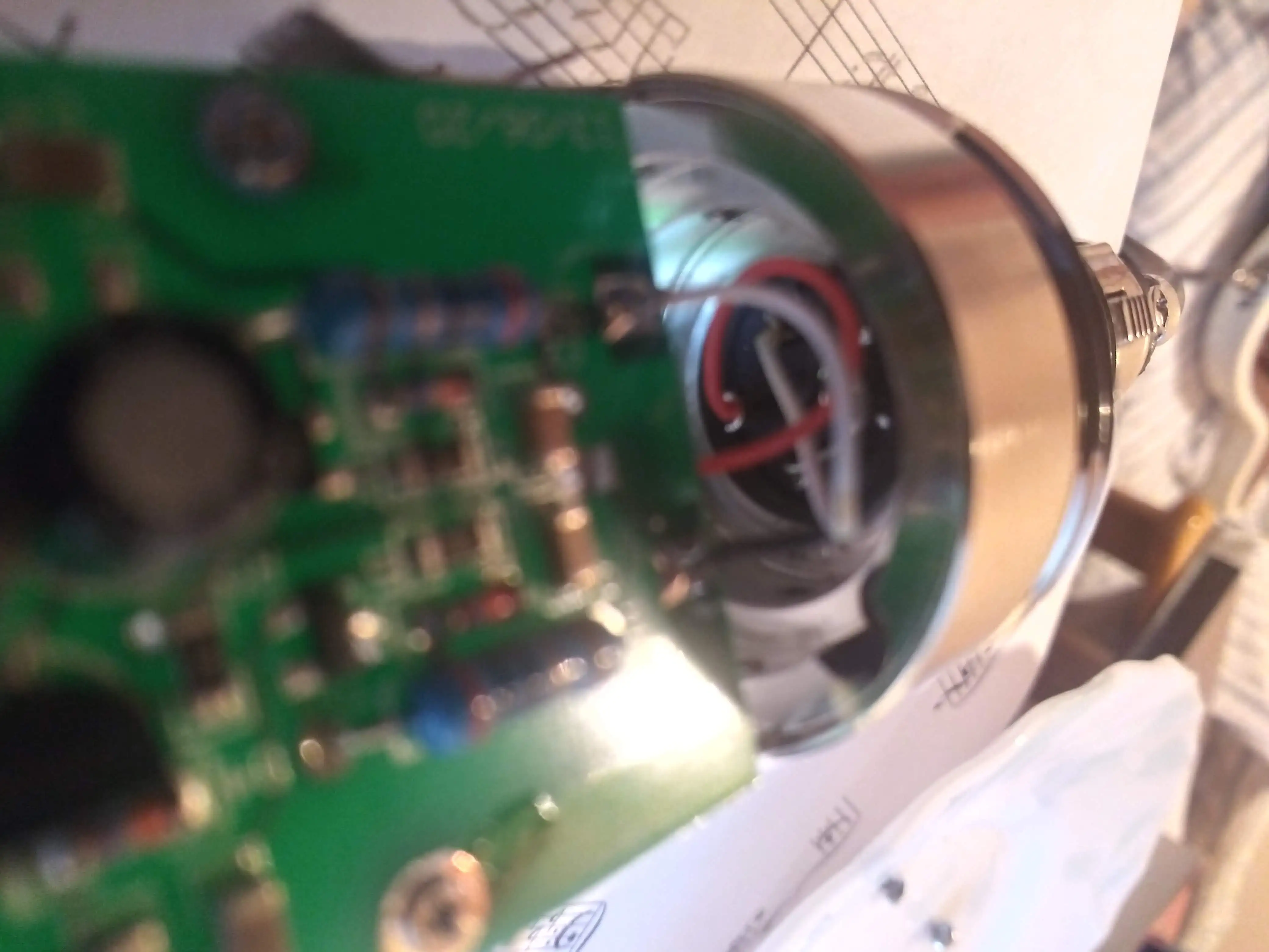

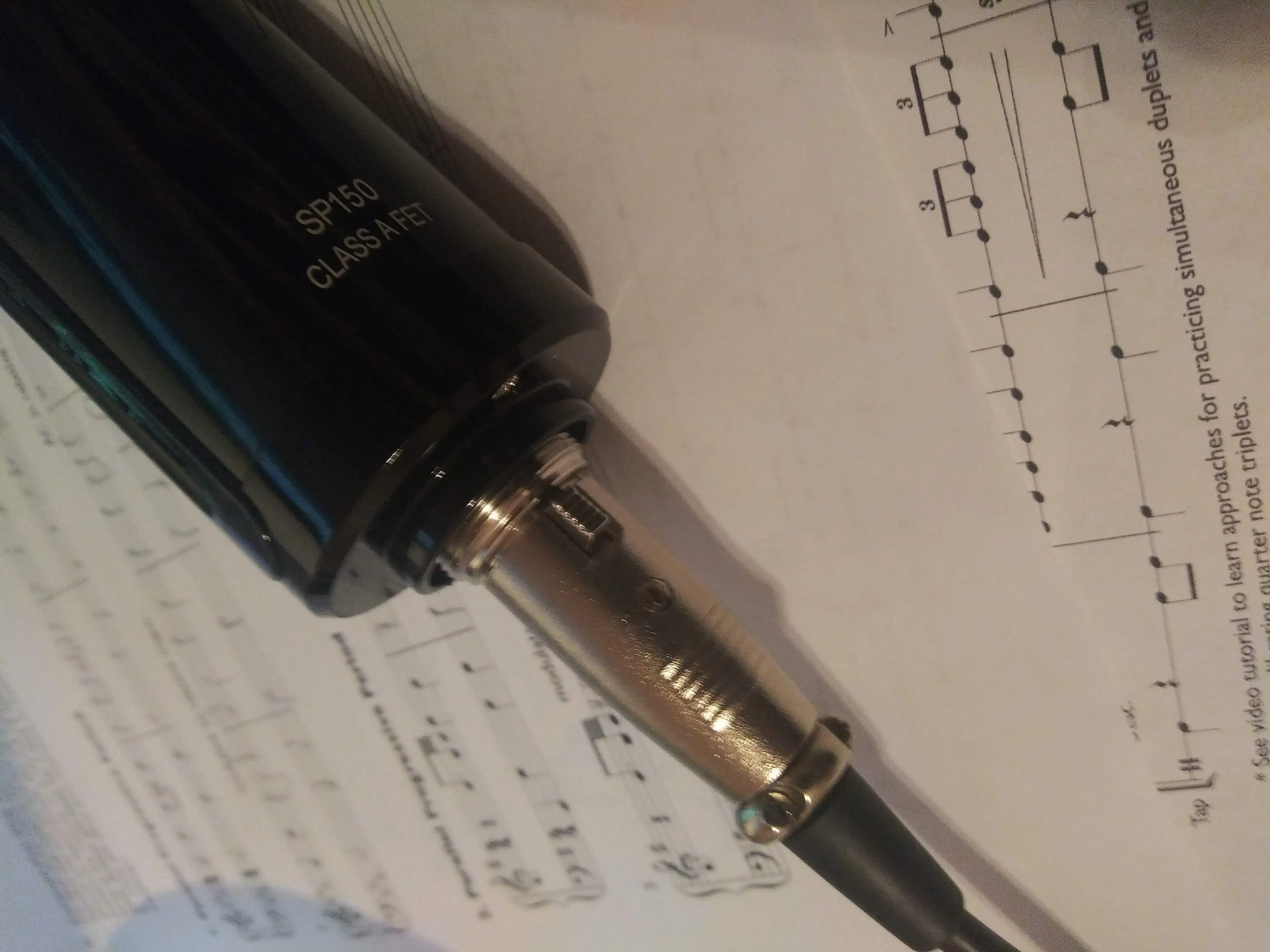

Issue Resolved!
I've managed to remove the cable from the microphone by removing the outer casing from the cable plug and placing a screw clamp on the release trigger, adding as much downward force on the trigger as I could. After that all it took was a light tug to get the cable out. I guess it was a matter of not being able to press the trigger down far enough with my own strength.
Although you can't really see to much that looks out of the ordinary, here's some pictures, at the request of user Chili:
Thanks to everyone who offered help and advice!
View attachment 106078View attachment 106077View attachment 106076View attachment 106075
