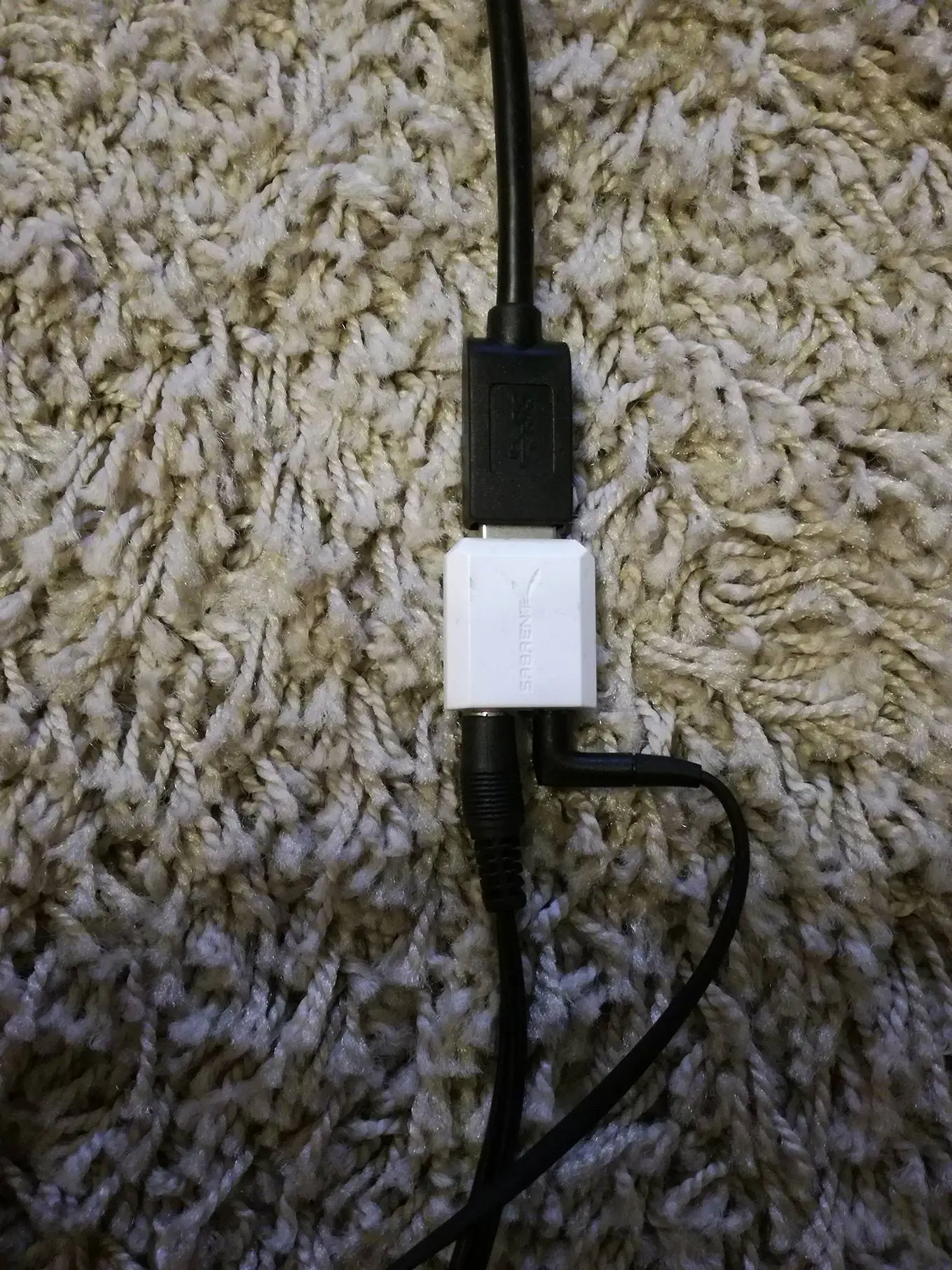

Does your 'USB sound card' in any way look like this one in this image from another HR thread...
If it does, the quality may not be too good and that could be the problem with the hum/noise you get. It may not be designed to power the BM800 properly either.

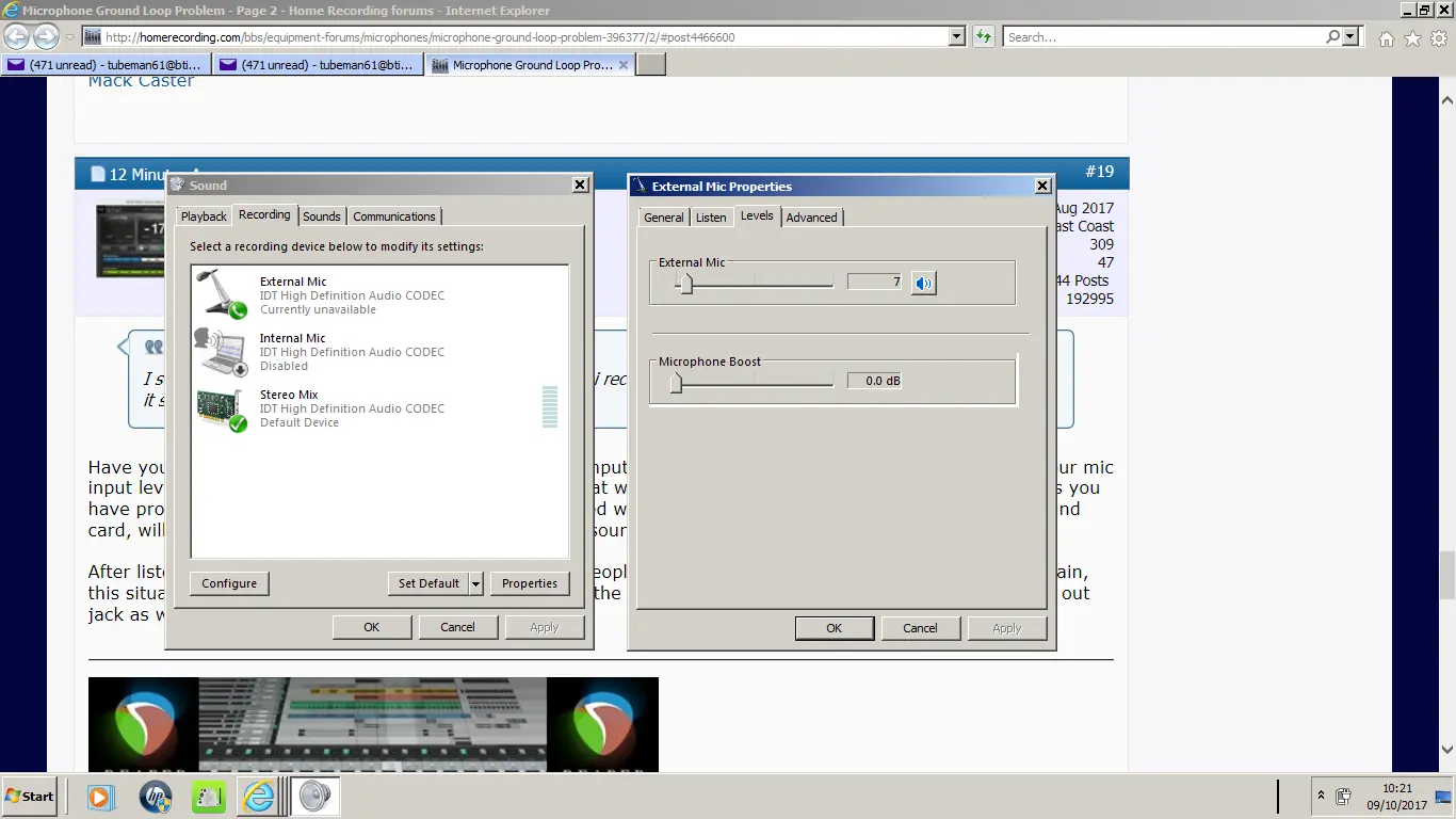

I agree that Windows needs its internal gain setting to optimize noise. The default for "External Microphone" is 100% and that is too high for most. When a generic USB interface is used, gain needs to be set to 5% or less. Best of course to use an AI that is 24 bits and has decent ASIO drivers. And that of course is by far the OP's best course of action, an interface.

Have you tried plugging in your mic straight into your computer mic input jack? If so, make sure you adjust your mic input level as described by others to the lowest setting that will allow the mic to work. According to all the links you have provided, this is what your mic is designed to be used with. Depending on the quality of your internal sound card, will determine the quality of your recording. Cheap sound card = bad recordings.
After listening to your audio link, that is the same noise people get when they do a mix minus using Skype. Again, this situation is also due to the quality of the sound card, the only difference is they are using their headphone out jack as well as their mic input jack.
Couple of pikkies in case you were wondering?
