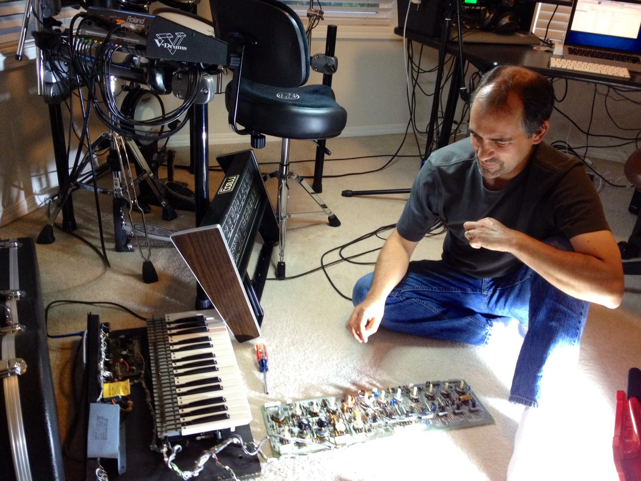

Here I'm pointing to the transistor and opamp that were replaced to enable the Sample & Hold circuit to work:
And here is a happy brother just moments after success was realized:
