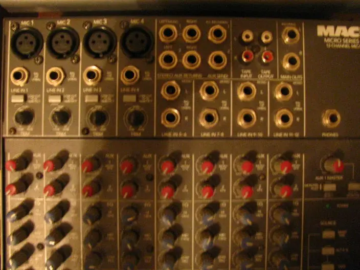

Hey there.
I've got an 8 channel mixer, except the second half of the tracks are stereo, so technically its a 12 track mixer.
I've got 7 mics to work with on my set: 1 snare, 1 bass, 3 toms, and 2 overheads.
There nice mics, and made for their specific drum, but Im not sure which microphones to put on each track. the 4 mono tracks have a 75 Hz Bass cut, and a trim, but the stereos don't. Which drums need the bass cut and trim, and which need the stereo? How would you set it up? Thanks.
Run the 2 overheads on a stereo track. Kick and snare on the mono tracks. Do the tom mics the best you can with the remaining tracks.
Sorry, Greg...gotta dog you on this one...
If you look at the picture of the mixer you will see only four XLR inputs, which means only four preamps, which means he can only plug in four mics with this mixer.
While it's kinda hard to read, it appears that the other inputs are labeled "Mono L" which is fairly common on smaller mixers. If this is the case, by plugging into only the "left" input the channel serves as a mono channel. Which would allow for the use of four external preamps to get a total of eight.
