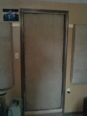

The room isn't optimal but I think I can make it work. It has the half glass rear exit door, a full glass door leading to a sunroom, a large double plane window looking out to the sunroom, and an open door jamb leading to the kitchen. It's also adjacent to the laundry room and the mechanical room. So, no laundry and no heat/ac during recordings. I'm thinking a sound panel that wedges into the jam to the kitchen instead of installing a door there as I prefer not to have a door there.

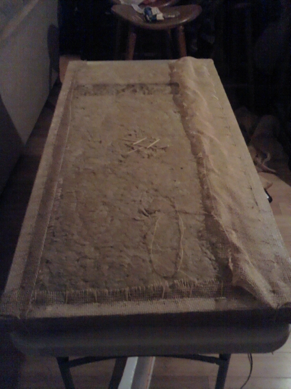

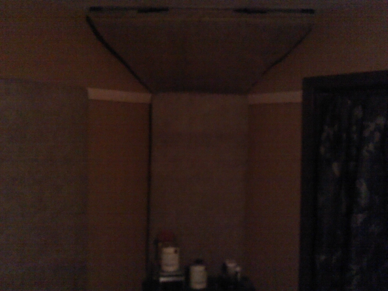

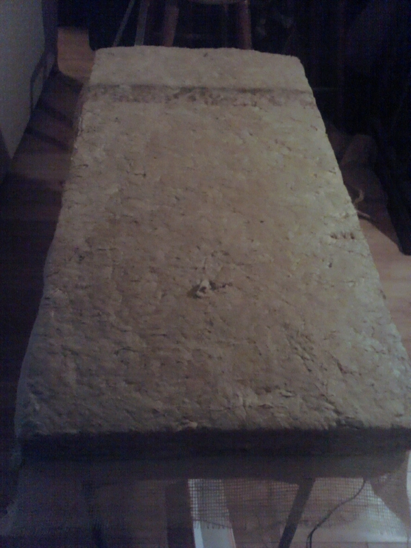

As for room treatments, I ordered some Roxul Safe'n'Sound and plan to build (4) 6" thick front and back bass traps (Floor to ceiling), (2) 3" thick 2'x4' front wall panels, (1) 6" thick 2'X4' Rear Wall Panel, (1) 6" thick panel to wedge into that open doorway mentioned above (rear wall), (2) 3" Thick 2' X 4' first reflection panels, (4) 3" thick 2'x4' panels for a cloud, and (2-3) additional 3" thick 2'x4' ceiling panels. wow, that's a lot of building isn't it. Shouldn't take too long once things get going though. What's the word on sound dampening curtains? Are they worth the trouble of making? I'm thinking of using some for the two doors and the window if it's worth the effort.
