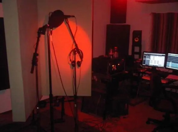

Not sure I would recommend singing into the worst sounding area of a square room. The corner. You will have the most open air in the center of the room. Here is a pic of my room when tracking vocals. Two 2x4'x4" rock wool panels hung from ceiling in center of my control room. Heavy blankets draped over boom stands forming a 'T' is what I used prior to building the absorbers and gave pretty much the same results. Didn't look as cool tho. Something on the wall behind the singer is very helpful as well. So is the red spot light. :)

I disagree. That is exactly why I recommended this setup. It helps to stop the flutter echo at the source. In an untreated room, the flutter echo will be no less present by moving to another location. A mic in a corner is just asking for more problems in an untreated room. My room is treated in all corners and 12 of these 2X4'X4" absorbers 5' apart on the walls with a cloud above the mixing desk. I recommended this 'behind mic' setup as it worked quite well before I built and installed the absorbers. I use the same basic setup with the appropriate materials now.
