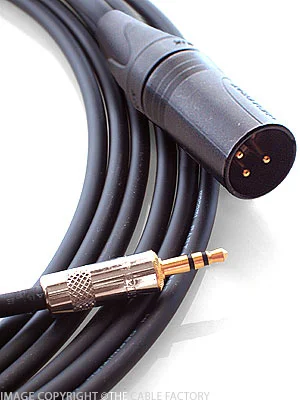

Also you can not plug a Mic into a Line in Jack, the line in is for Line level sources and the Mic in is for mic level sources....If you want to use the Line in Jack you will need to get an external Mic preamp to the plug the mic into and then from the output of the preamp into the line in on the sound card....
Do yourself a huge favor and get a microphone preamp. The ones built into most sound cards (which is the mic in jack) are very poor, noisy, and for most mics (except those crappy $10 voice chat mics at wal-mart), will not have enough gain.
Even one like the M-Audio Audio Buddy (which I think came down in price to around $60 new) would be so much better. The DMP3 is probably the best preamp in the budget range and goes for $150 new.
Without one, you're only chance is to use the mic in jack and hope for the best. Chances are, you will just get a very noisy, low-level signal.
