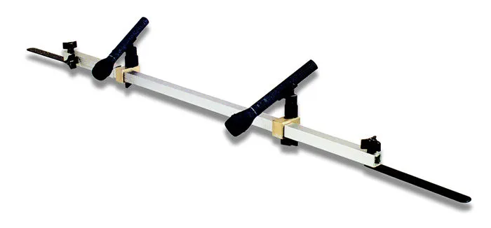

Someone makes a mic bar that attaches to the sides of the piano and stretches across the strings. It has clips for two mics. I can't remember who makes it though.
Probably it's a better design than directly clamping onto the harp, which is more likely to create some unwanted resonances or buzzes.
Ok, the name of the product is “Slider Piano Barre Microphone Mount System” and I've just emailed who I think is their Parent company (LM Products www.lmproducts.com )
I found this company by searching and finding http://www.slider-straps.com I emailed them and found out that LM Products is their Parent company.. so that's where I am now.. I'll hopefully get an email back from them.
I don't think that the Piano Barre system is still in production.. but we can hope..
FOR THE SAKE OF Chris F.. PLEASE LET IT BE!
:D
Actually, seems like it wouldn't be too difficult to come up with a DIY version. You could even make the crossbar out of wood.
