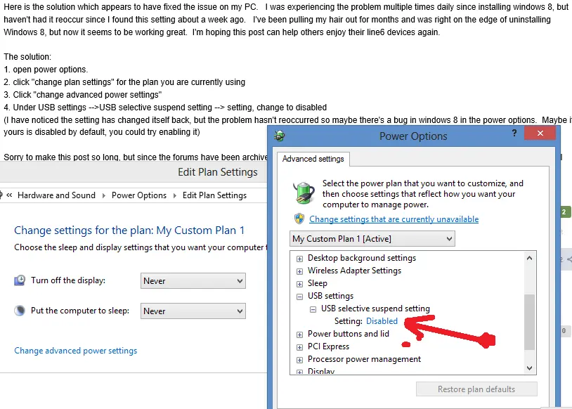

EDIT 6: all roads lead to Microsoft and there I found many posts about the same issue. the audio sound disappearing after 1minute to several hours.
I also uninstalled an reinstalled all audio drivers.
But here is what appears to be the very odd problem in Windows 8

I haven't had one issue since, so it probably wasn't any of the media players btw... probably the fact I didn't know how to setup the pc (and deselect Window garbage)
