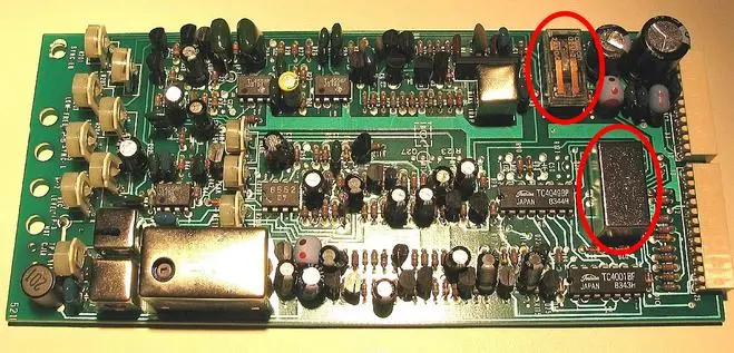

  • Have you reseated all the cards? By reseating I mean pulled the card from its socket, applied some DeoxIT D5 or DeoxIT Gold to the card socket, plugged it in and unplugged it a time or two to "exercise" the connection?
  • Have you reseated the cable connections between the meter/amp unit and the transport? Does there appear to be any oxidation on these connections?
Once you have addressed the above questions/procedures, and if the problem remains then answer me this:
Is the global issue (all tracks intermittent in sync) kind of like an "I'm going nuts...this is driving me freaking crazy" problem that you can't seem to nail down, like its changing all the time and some channels work sometimes and not others and you just want to cry?
If so, and others may disagree and if there is something else to consider before jumping to this possibility I hope they chime in, but it may be time to replace the relays on the amp cards.
I had this same hair-tearing experience on my 58, which uses the same amp cards BTW...at the time I was able to rectify the issue by opening up the relays and cleaning them, but if they are exhibiting problems then cleaning them is a temporary measure at best. The real solution is to replace them. On the 58 and MS-16 amp cards there are two relays per card. I put a picture below and outlined the two relays. Notice one has a chrome cover over it, the other doesn't...they both should have the covers. For some reason the covers were missing on one set of relays on my 58. Anyway, those are them...you've got 32 of them and its what I'd be looking at as the problem.
Also, yes SOME of the IC's on those amp cards provide for signal amplification, but understand that they don't function on an island. Many components play into that amplification...setting the internal gain, filtering, etc. And some of those IC's do other things like serving as a comparator to tell the peak LED when to light, or driving the VU meter needle...remember, gettin' all probey with yer probes, yada-yada...
Also, in my experience, the failure mode for an amplifier IC is "I quit", not "I'm not workin' so good". In my experience they have problems if they've been overdriven and then they cook and are done. Just another bit to add to the brain there on why I wouldn't personally jump to the assumption that an opamp is bad...if you are getting *some* sound, then the "amp" is working.
Here's that picture:

The cleaning/reseating of the cable connections could make things temporarily better if it is a relay issue...
I didn't replace my relays...I just cleaned them and it took care of the problem...but then I made a careless error and toasted that mint-mint-mint condition 58.

So when you monitor the input on channel 6 the output level is okay? Its just when you are monitoring in sync mode?
You don't "re-seat" the relays. If you are going to take an iron to them then it better be to replace them, and if you are thinking of replacing them then don't bother cleaning them.
If the problem is only in sync mode globally, have you tried reseating the head connector for the sync head?
Those relays I linked are better than stock and were used by another member on his MS-16.
