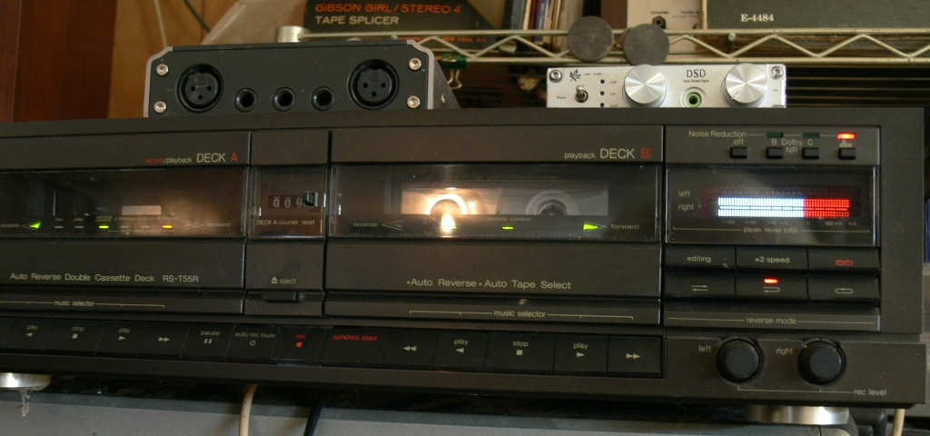

Quick and dirty is a dual well, high-speed dubbing deck. I happen to have a pic of one already loaded.

Ya' can't beat the computer for editing and possibly making a whole different sounding album. Even doing this, the cassette stage can be quite tedious. On the dubbing deck, press one button and the 30-minute cassette is done in 15-minute.
This one in the photo would be "good enough". I know some have wide-range pitch control and auto-calibrate, for example
