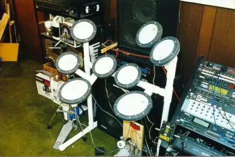

Good site that shows how to build your own electronic drums.
diy-e-drums.fish-the-net.com
