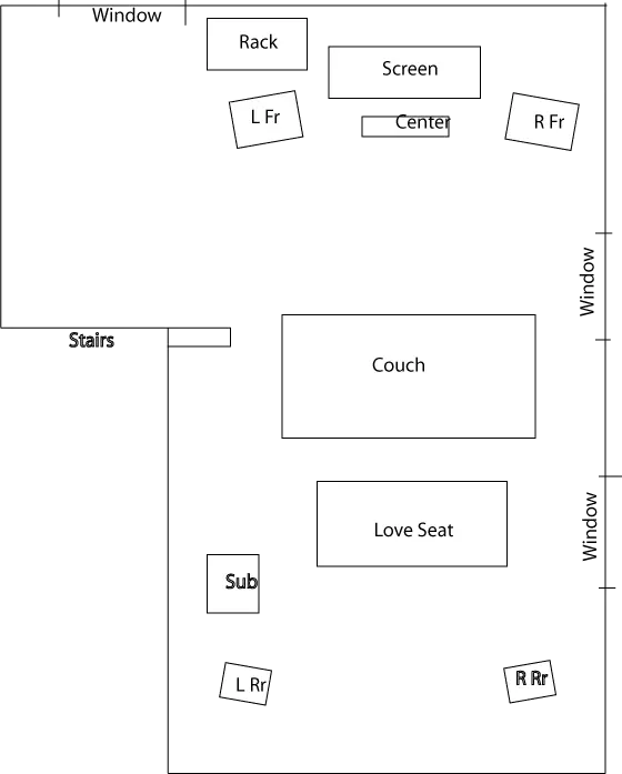

Ok first I would like to thank all the people that have replied to this thread, you "k"nowledge has helped a lot. So below this text is a PDF layout of my room that I would like to have the control set up in. Right now its my home theatre system and there will be enough room to set up my Pro Tools system behing the love seat. The room demensions are 22'x13'x8' with wooden floors and ceiling. My question is, how much 703 and 705 should I use and where would be good locations. This will be for a home theatre setup and a control room setup. There are slanted ceilings on both ends of the room i think they start at 4 feet then continue up at a 45 degree angle. So that may make things different.
About the sound of the room. Well, I put up a layer of 1/2" sheet over the old existing wall and put up some tounge and groove paneling on the ceiling which brightened the sound of the room abit. So right now theres luts of fluttering going on, some really harsh peaks through out the room. When I was doing pink noise testing on the sub, 40 hert test tone, I noticed a lot of bass amplitude and bass depression everywhere. This room needs Help!

Oh and BTW the rear speakers are mounted from the 45 ceiling.

JB,
> layout of my room <
I'd rearrange the layout to be upside down if possible, so the listening position faces up from the bottom. That will make it symmetrical on the left and right, which you need.
> how much 703 and 705 should I use and where <
Straddle as many corners as you can using rigid fiberglass that's 3 or 4 inches thick. Then put more panels on the walls and ceiling at the first reflection points, though those can be only 2 inches thick. Then you can add more as needed.
> right now theres luts of fluttering <
You can treat opposing parallel walls using 2-inch thick rigid fiberglass applied in stripes or a checkerboard pattern to cover half of those surfaces.
--Ethan
Excellant, I was taking in consideration of flip-flopping the listen postion, but when I get reference monitors shouldn't they be in the back of the room behind the love seat then use my current system as another reference. Which one would be more crucial to have setup in the back, the HT system on the ProTools setup? I know the "L" is a disadvantage but right now I have a portable wall 8'x6' (lxh) with thick blankets covering it so it is dividing that little extra space from the rest, it doesn't do much, but its more as a mental feeling that it is actually doing something.
I took some measurements for the placements of the panelings and I think four panels setup in the bottom left, bottom right and top right corners so there would be two panels on each wall meeting eachother in the corner. And that center left small corner you can see on the picture would perfectly fitting one panel laying across the corner and then do the same for the top left corner by the window.
So there would be 12 panels acting as bass trapts then roughly 20 placed throughout the room. Does that sound right for that size of a room? That would cover 4 on the ceiling, 4 on the slanted ceiling and the remaining will be placed through out the room. and right now theres just one thick rug in front of the center channel speaker meeting the listening postion just to absorb so dialog when watching movies.

JB,
> when I get reference monitors shouldn't they be in the back of the room <
Here are two links you'll find useful. The first is my recent article from EQ magazine that details the construction of a surround mix room, and shows where all five speakers should go:
http://www.realtraps.com/art_studio.htm
This next one explains how to set up speakers and the listening position, and it offers additional insights not covered in the first article above:
http://www.realtraps.com/art_room-setup.htm
> So there would be 12 panels acting as bass trapts then roughly 20 placed throughout the room. Does that sound right for that size of a room? <
Yes, that's great, as long as the panels are thick enough. As for cost, expect to pay somewhere between 30 and 60 cents per square foot for 703 one inch thick. Double that for 705, and/or multiply times 2, 3, or 4 for panels 2, 3, or 4 inches thick.
--Ethan
