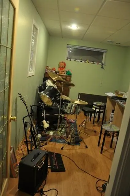

So recently my friends and I formed a band. And we practice in my room. We have 2 guitar 15watt amps, drum set, recently purchased a vocal monitor (120watt vocal monitor Beringer eurolive F1220A). And of course microphone,mixer and some other recording gears.

I've declined the seller since then. Today I tried out a rode NT1A rental condenser mic and found that the room has A LOT of funny acoustics going on. There would suddenly be scratchy sounds going into the recording...
I would like to know what the cause of that is (i'll provide clip upon request) and was wondering where I should put absorbers/ panels down in this studio/practice space of mine?

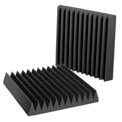

2:Auralex
Wedgies 1'X1'X2
These things go for $110 at my local music store (unsure of the size but see link) and go for $5 at zzound lol that's $105 in difference
Long & McQuade - Auralex Wedgies 1'X1'X2
Auralex Studiofoam Acoustic Wedges, Gray, Single at zZounds

2:Auralex
Wedgies 1'X1'X2

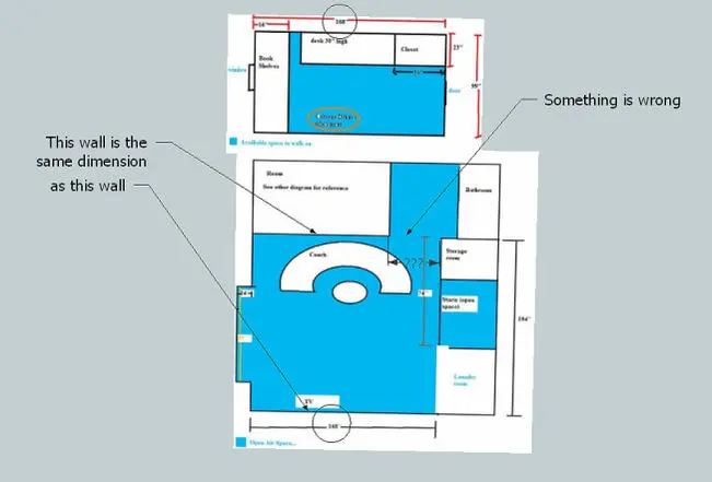

SMALL ROOM DIAGRAM
Would love to receive some suggestions.
I would. But your diagram leaves a lot to be desired...like correct dimensions.
Here is BOTH your diagrams. The bottom wall on the big diagram is labled 168". The long wall on the small diagram also says 168". According to the large diagram..that is impossible as it shows the small room relative to the big room...and there still is a small hallway width to figure into the 168".:rolleyes: So what gives?
Please revise your diagram to reflect reality..and provide ALL dimensions. Then I can help you.
fitZ:)

Hey FitZ you are absolutely right! I actually never really realized the basement looks like that until I looked into the dimensions!! Lets just say... the dimensions are correct and that my diagram is worse than "not drawn to scale"
I would gladly draw another one (and attempt to make it better :( ) but I think the video might do more justice YouTube - ‪MVI_5724.AVI‬‏

Thanks again :) I will try to update the diagram if I could tomorrow.
