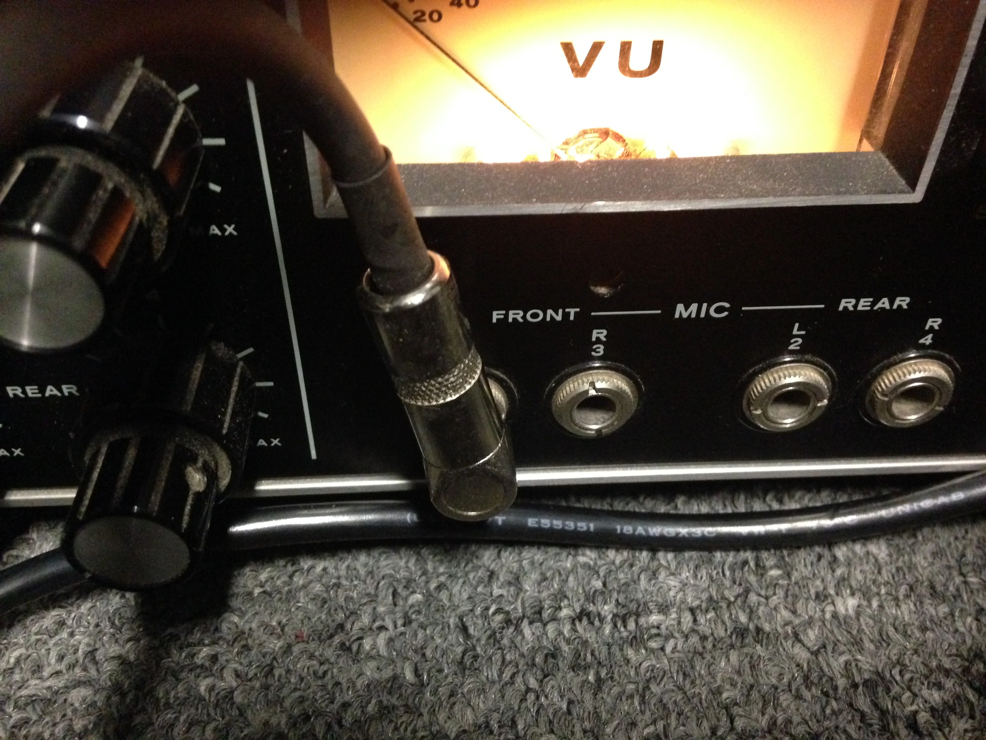

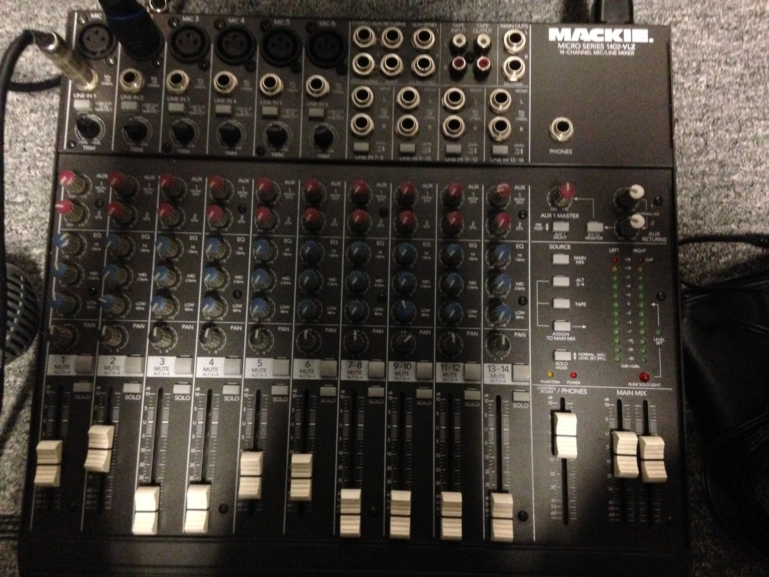

Hello,
I have a TEAC 2340 that I'm trying to connect a Mackie mixer through. The TEAC has four 1/4 inputs on the front and I assume that I'm connecting those to the 1/4 direct outs(channel inserts as labeled on the board) to record on to the tape. I also hooked up the RCA outputs on the back to the Tape-In on the board to hear the playback. My issue is how does the EQ and fader level take part in all this? The direct outs are pre-fader and the Tape-in seems to just send it to the monitor. Any advice would be greatly appreciated. Thank you!

As you've discovered, the direct-outs are pre-fade, pre-EQ, which (generally) is as they should be. That means the only control you have on the Mackie is the gain setting.
If you want to use faders and EQ, your options for getting four discrete outputs are limited. You could use main out L & R for two, then Aux 1 and Aux 2 for the other two. However, I expect Aux 2 will be set up as post fade. Or maybe, by using mute buttons, you can use the Alt 3/4 outputs for the other two.
Going into the A2340, you may not be able to use the jacks at the front. They look like mike inputs. You may have to use the RCA line inputs around the back somewhere.

Which model is the Mackie mixer?
I ask because I don't see any direct outs on the picture posted of that board.

The Mackie 1402 mixer has no direct outs and sadder still is not really designed for multitrack recording work. It's far more so a PA mixer.
That said, I might suggest using a few separate outboard mic preamp units and using the Mackie as your monitoring and mixdown mixer.
Using the rear apron insert points is really no better then making use of the mic inputs on the Teac as you'll end up with the same amount of control over the signal, that being mic trim alone in either scenario.
I guess the Mackie might be preferred if you have mic which require a Canon/xlr connector but beyond that, there's little benefit of using the Mackie mic preamps.
Ultimately, a different mixer with a proper 4 buss architecture would be the best way to go as that would give you all the proper routing possibilities without resorting to bastardizing the Mackie insert points which will bypass the eq and channel faders if you use them as a surrogate buss feed.

The Mackie doesn't have direct outs as such, but it does have inserts on the back which can be put to use as direct outs easy enough
Yes, that's been acknowledged but if the insert point is pre-eq in the signal chain there little benefit to employing them considering that the Teac reel to reel has decent mic inputs directly on board along with line inputs round the back. So from a connection simplicity standpoint, it might be simpler to use the recorder's front end for tracking and leave the Mackie for monitoring and mix downs, short of getting a proper 4 buss recording board, mentioned in my previous post.

Yeah that makes sense. I forgot the teac has onboard mic pres.
