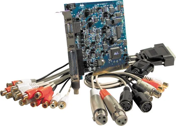

Right. Well i discovered that the card i was looking at was not a 1010 but a 1010 lt. The 1010 lt is apparently basically the same card, but with all the wires coming out of the card rather than having to run it in to a patching bay. This is obviously a cheaper solution. Basically all i want is to be able to record multiple inputs as discreet (seperate) channels on cubase. A mixing desk is obviously more expensive and i would need to upgrade my soundcard anyway, because it is nasty and as a result is limiting quality and latency (by over a second!!).
My inputs will be mostly 1/4" jack leads. Do you know if this card (the LT) has the 8 analogue inputs as female jack heads? If not what are they? what does it mean by I/O? and unbalenced inputs?

the lt is unbalanced and the convertors are on the card instead of in the breakout box so the signal to noise ratio isn't quite as good.
Also, all the ins and outs on the lt are on moulded plugs. To me that's a potential nightmare. If I was gonna be swapping cables in and out of the lt I'd have it permanently hard wired to a patch bay and do all my switching from there.
I hadn't seen a 1010lt card up close like that untill now...it looks really crammed compared to the real deal 1010. More components = more heat = more noise
I am using the LT. It is a great card. Just get you a couple 1/4" to RCA 8 channel snakes from www.pulsartech.com and you are golden. There really is not a noise issue. Mine is shoved into a noisey Dell and I have had no problems. There is a small learning curve but nothing that a normal person cannot overcome. I recommend it highly. I am going to get another one as well just for kicks.
My vote is for the Delta 1010 (with the box). I looked at both and went with the 1010 because of the balanced I/O. Depends on your need and goal - if it's for fun and learning you might want the cheaper option so you can go bigger if you want to upgrade

I do appreciate that the LT is an inferior card but, hey its my first and im absolutely skint. So the cheap LT it is. It inspires confidence that you've been ok with it using a dell (as thats what i intend to install it in). Upgrading dells is a bitch.

no, you only have 8 channels. It says 10 but 2 are digital (spdif). The cables you need will have one RCA on one end and one 1/4" on the other. Or in my case, I have snakes with 8 on each end.
