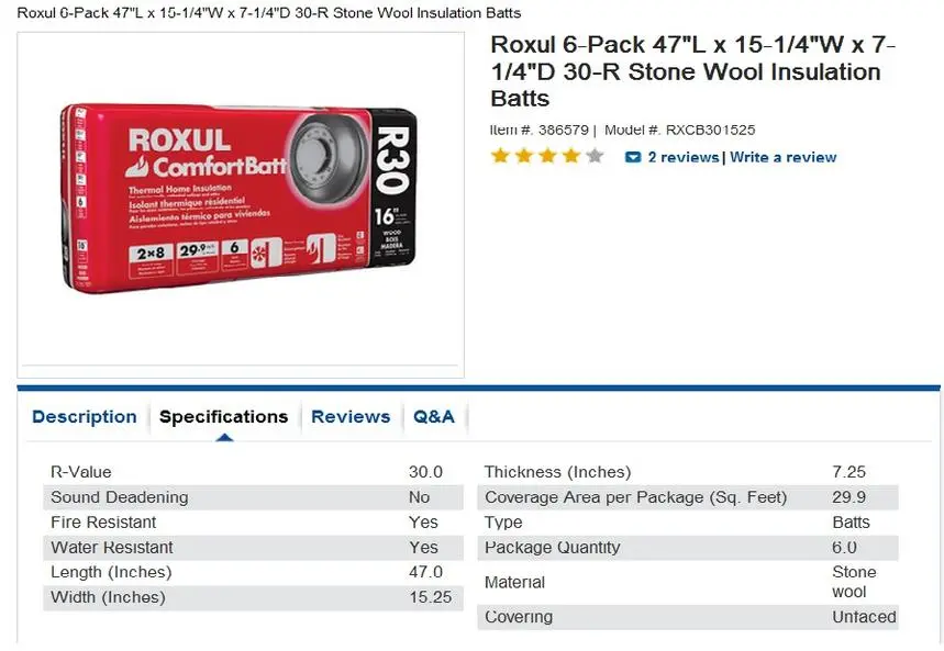

Shop Roxul 6-Pack 47"L x 15-1/4"W x 7-1/4"D 30-R Stone Wool Insulation Batts at Lowes.com
Im guessing itll absorb bass really well compared with other products, only ~$40 for for 30 sq feet. They also carry other roxul of varrying thickness if you search roxul. Im about to order it, any reason i shouldnt?

Something in the specs looks odd to me.
