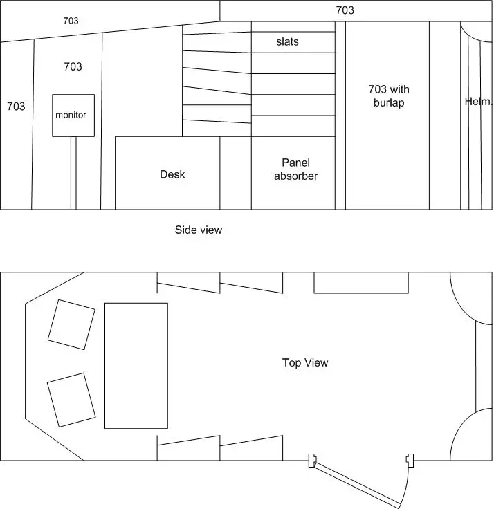

current plan
I am getting to the point where it is time to build all of these treatments and start making music.
I attached what I am now planning to do after reading a lot. I plan to fill the back corners with regular insulation and the side units as well, except for the bottom panel absorber which will be 703.
Ryan

Looking at your plan, I think the side reflectors are angled in the wrong direction. The way you have them angled, they'll be reflecting right back toward the mixing position. I believe you want them angled the other way, so that the reflections make the room wider, not narrower.
I also wonder if you have too much stuff going on in such a small space, but that would be a question for folks MUCH more advanced than me.
