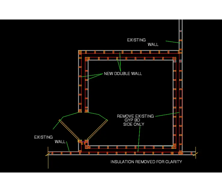

Many questions to answer before suggesting solutions. No time right now. I'll be back later. Here is something to ponder. There is MUCHO other considerations implied by this simple concept though. Do not take this as complete, as it does not show floor, ceiling, connections, seals and many other details. Not to mention weight. But if isolation from within the existing roo, this is the direction you should consider. Do a search on TWO LEAF ASSEMBLIES. Then you will understand why.
Hey thanks for the image rick! Even though that's just the sides, that still helps a lot to visualize what I need to do. The only thing I don't quite understand is 'remove existing gyp bd side only'.

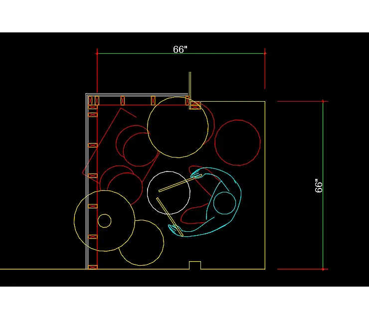

WHAT WAS I THINKING? :rolleyes: Time to measure your drums. Then take a reality check. Sorry.

looks like im going with a rectangle, probably around a 4'x6' or a 5'x7', only because im going to use a small jazz type kit, 18, 14, 12 + snare.

well I'm not all too concerned with fitting a drumset in the space, as the last time I recorded we managed to fit the drumset into my tiny bedroom next door and the available space was definately less than 5'x7' We could only get one of us in the room (he was already behind the set while we set it up, and then another person could stand in the doorway, that was about it. I guess I can go over to the drummer's house and measure his drumset if you really think it's going to be a big problem.
