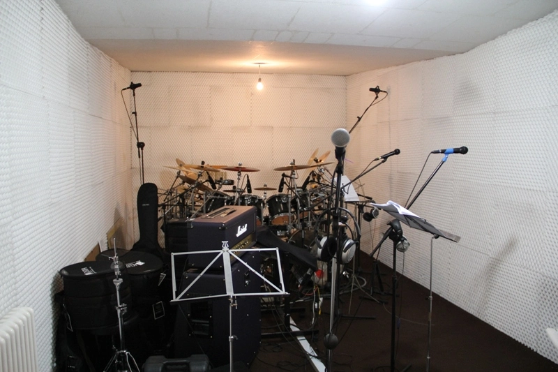

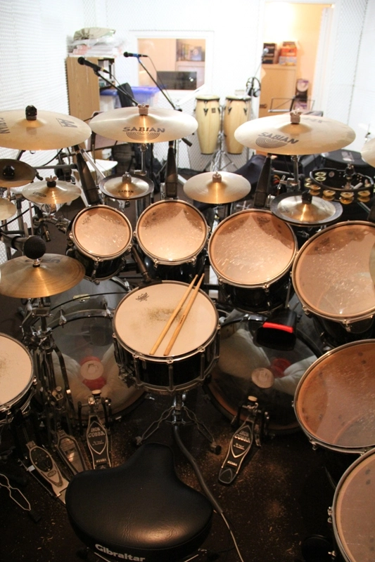

Again, thanks for your feeback. I've probably should have described our set-up better in the first place. I will remedy now. We play for fun, attached a couple of pictures of our reharsal room. I designed and built it and I'm quite proud of it. :-) There is four of us: a drummer, a guitar player, a bass player, a singer. Each of the musicians also sings bg vocals.
In the middle of the room (covered by a black dust cover in the pic) there is a Behringer 2442fx (now I know many of you are turning up their noses, but hey). The drums are all mic'd and all cables go to 2 x M-Audio Profire 2626 in the control room (behind the window) that I use to record (protools 8). I use two Profire outs to send to the room mixer a stereo mix of the drums. So the channels of the room mixer I am using are: 1-vox, 2-guitar (from amp), 3-bass (DI), 4-gp vox, 5-bp vox, 6-d vox, 7+8 stereo drums. The 2442fx uses the 3rd aux to manage the on-board fx section. Three of us got a TC mic mechanics for vocals. So I could use all 4 aux sends for 4 individual mixes by turning off the on-board fx section. The 4 auxes would go into a phone amplifier (Behringer powerplay4600) which has 4 channels (each with his own aux) and supports 12 outs. So far we've been feeding the amplifier our whole stereo mix + individual aux for the more-me feature (the unit has a general/aux knob to balance each channel whole/more-me signal).
This is when I posted the help request. Using 4 auxes to send 4 individual mixes works, no problem, except what I said: the singer and guitar player love to turn and touch the faders and knobs and they usually make one mess or two :-) No big deal, but I was nevertheless looking for something that would allow them to manage their own mix. Also, the fx section in this configuration had to be turned off.
Since when I posted the msg, the singer has also pointed out that he would still love to have a reverb 100% of the time + turning delay off/on with his pedal. This added one difficulty: using the on-board fx to provide the reverb and still deliver 4 independent mixes.
I guess this could be accomplished by using 3 auxes to provide 3 individual mixes and 1 subgroub to provide the fourth. After all, we do not really need the main out. The 3rd aux would be used to send the signal to the onboard fx section. The stereo fx out from the back of the mixer would be fed to one stereo channel on front to add the on board fx to the aux phone mixes.
