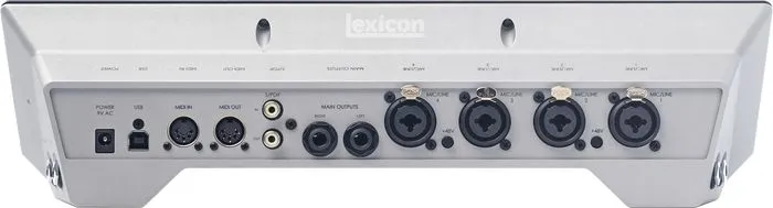

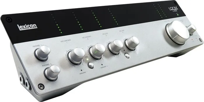

I guess the Lexicon name doesn't mean as much to me as it does to some people. That thing costs as much as a FIREPOD, but has only half as many input channels, plus it presumably has all the problems inherent in USB audio transport. The first words that come to mind are "massively overpriced", but that's just my gut talking here.
I agree that I wouldn't buy it on the Lexicon name alone, but knowing now that they put 4 dbx preamps in it, it's intriguing. According to Lexicon's site, you also get the Pantheon plugins - assuming that might be important to you. The specs I've seen look good, but as they just started hitting shelves this week, I doubt anyone has actually used one yet...
It looks huuuuge!
Essentially it has 4 balenced inputs, MIDI I/O and some spdif. I would not expect it to be that big!
Im very concious of desk space, and I would say this doesn't have enough features to warrent the size. Who can really say they need 8 LED's on an input indicator, just to monitor 4 channels? This seems to take up most of the space.
Ignoring this fact, it looks sexy and has a higher spec than their other audio interfaces.
I like the form factor and looks like it will be in reach, but not in the way. I'm curious if you would be able to apply reverb to a channel without it going to the computer to help a singer during tracking.
Is the Pantheon reverb plug processed in the unit or do you have to load it up on the computer? I would think the load on the USB buss would be fairly large if the plug ran inside the unit and also had to handle 6 channels of input and two channels of out.
I like that they included a second headphone out with level knob. Cool.
