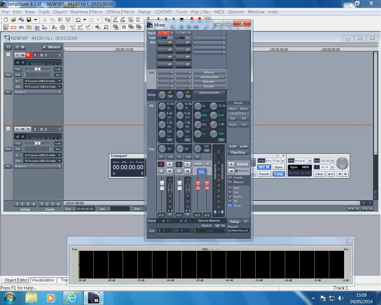

Select the input (usually a pair) and select either Left or Right instead of stereo. If you select mono, it sums the left and right to a mono track. Samplitude basically works on stereo tracks. Even when you select mono (and it will record a mono track), Your AudioLink is sending two inputs that samplitude (and probably the other software) is seeing as a single stereo set. Set one track to record L and the other to record R and you'll have two mono tracks.
There you go. (sorry, don't have Sam 11 but pretty sure they all work the same)
Point to note is that the left and right channel are panned hard left and right in the mixer?
You get two mono channels when you start a project, Select 2 channels and set "mixer setup" to mono.
Or, you can set "Project Template" to 8 mono channels.
I REALLY like Samplitude! Wish I could afford/justify Pro X!
