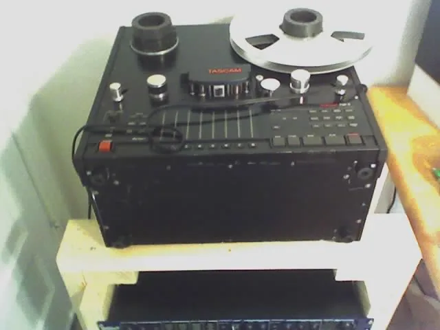

I spent tonight building a cart to hold the tsr in a horizontal position. I built it low enough that I can see the meters, and if it is a problem i can always angle it up. Ive also left a space for rack mounting. It still needs a little work, but I'll post some pics tomorrow

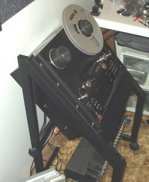

The angle is not adjustable but the price was right and it works well for me.

Below is a pic of mine from Stand Solutions. If I could have had it made to order I think I would have had it tilted back a bit more, but it seems to be running well as is:

i'm planning on tilt mounting as well. I wanted to run it horizontal for editing and tape loops (cause it's easier to mark and cut on a block) but the VU's make it impractical.
(i'm using the Tascam 38 btw)

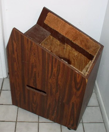

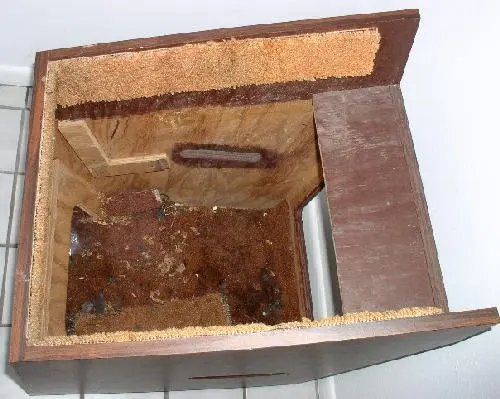

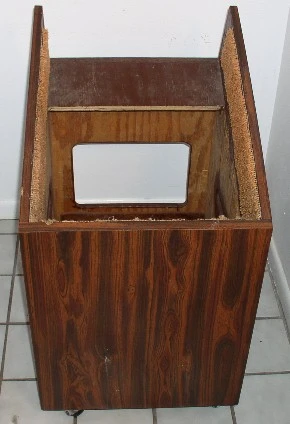

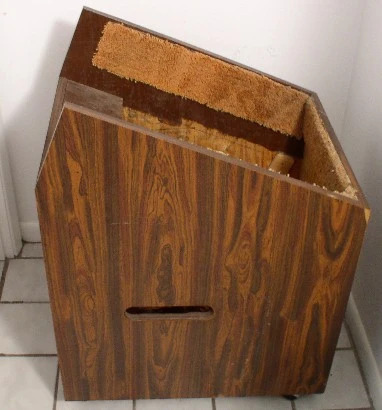

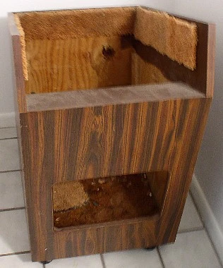

While we’re on the subject of racking reel-to-reels, I thought I’d post these pics I saved from an ebay auction sometime back. I didn’t bid on it but I saved the pics for future reference. My studio is pretty spartan when it comes to racks and such, but deep down I’m a warm wood and fireplace kinda guy. I hope someday to make my studio look as pretty as it sounds.
Maybe these will give some inspiration and ideas for those handy with carpentry (which, I’m not that good at). If my dear father were still with us, he’d whip something like this up for me in a jiffy.
