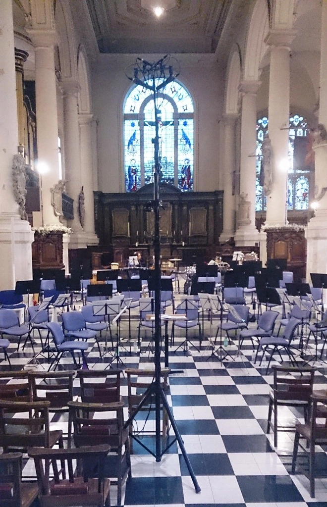

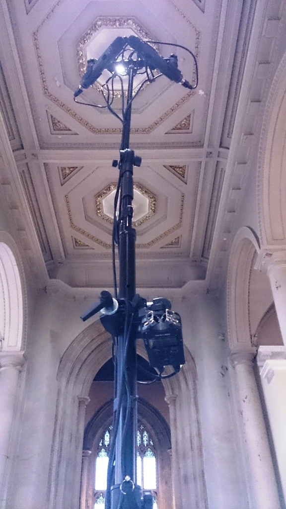

The last time (Sunday 7th Feb), I had invested in a pair of Rode M5 and recorded on a high mic stand (modified lighting stand), with mic height at approx 3.5m, and approx 3 m in front of the front row of musicians. Recording config was X-Y, 90 degree angle, with the mics angled down m-d distance between front and rear of the ensemble.
