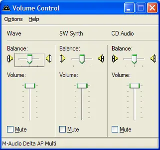

3. Most of the time, input levels are set on the recording equipment (ie the preamp). If you don't have one, then you will probably want to do it through the Windows Volume mixer. On XP, there is a little icon in the system tray that looks like a speaker or a mixer. If you double click that it will open up your volume settings. You can go to Options -> Properties -> Recording and set the input level of the recording device (Microphone or Line-In).
I attached a small screen shot so you can see what window I'm talking about.
