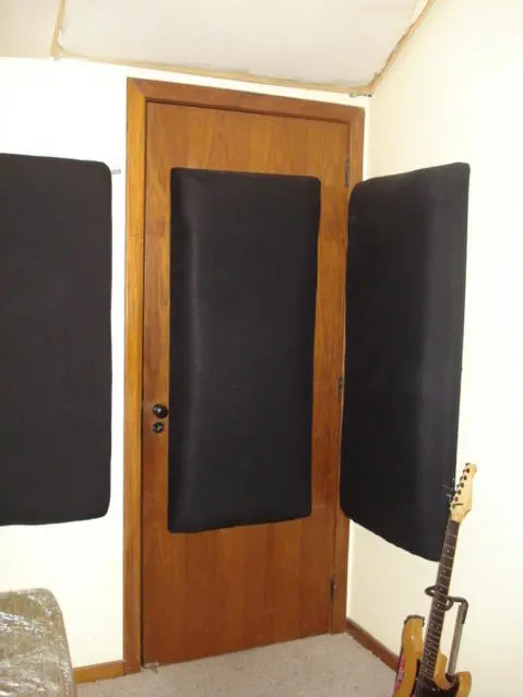

But some nasty nulls in a small room (what´s the dimensions?) comes from the rear wall.See what I did here (seems you have a door too?).
Note that the wall/ceiling corner is treated.The traps are 4" with 2"gap, and the center one(half in the pic) is 6"+4" gap.The opposite side has the same treatment.
Ciro

Seems a good plan.
This plus a software measurement for check the best response + mix and speakers placement.
In a small room, like this seems to be, moving the speakers
3" or 4" can be the difference by the "golden point" for another in a strong null point, and a software will show this + the decay times and modal ringin with a fast sweep (5s or so).
I use Room Eq Wizard.
Ciro
