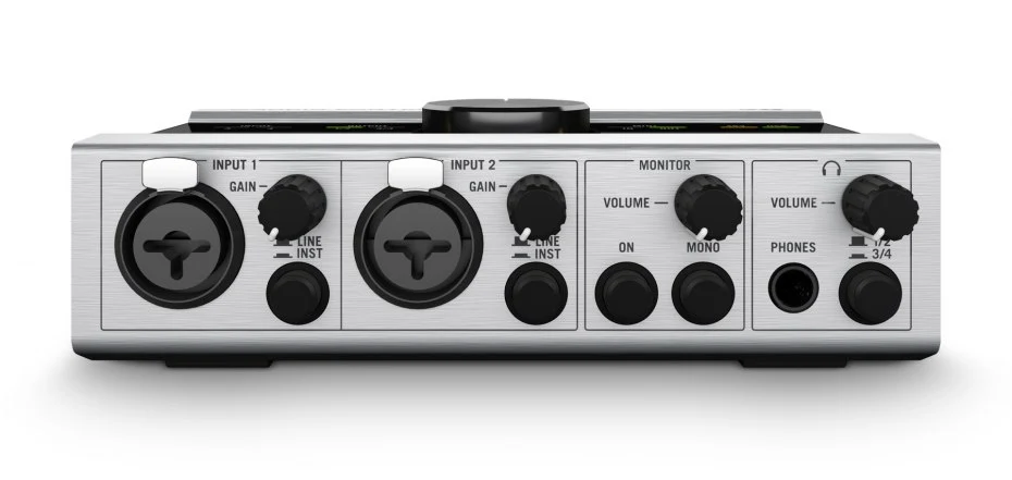

I was going by the pictures I saw in google.
As I look further I see there are variants. One that has just a monitor button and level.
Yes, the KA6 only has two buttons (on/off and mono/stereo) and a volume knob for monitoring.

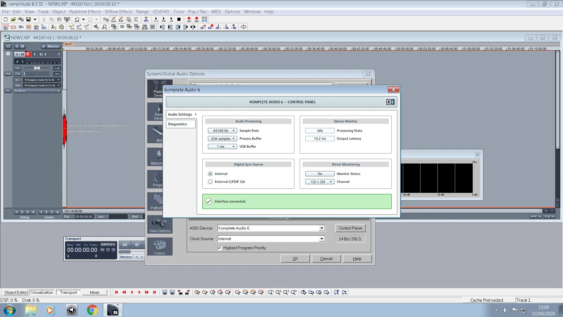

Hmm, odd. That screenshot clearly shows you should be able to direct monitor 3/4 (the other options are, just 1/2, just 3/4) but I have just done a quick rig in Sam 8SE AND yes input one I hear in cans, 3/4 I do not no matter the setting in Sam or the selection on the front panel.
Playing back a track routed to 3/4 gives me sound. I would have said "the FA6 does an awful lot, very well for its money and DMon on 3/4 is perhaps being greedy? But then why suggest you CAN do it in the Control Panel.
A firmware update yet to be enacted?

Hmm, odd. That screenshot clearly shows...
I didn't post a screenshot...:confused:
...clearly shows you should be able to direct monitor 3/4 (the other options are, just 1/2, just 3/4) but I have just done a quick rig in Sam 8SE AND yes input one I hear in cans, 3/4 I do not no matter the setting in Sam or the selection on the front panel.
To sum up what scattered around in the user manual, the Direct Monitoring feature only works for Inputs 1/2 (XLR/Line jacks on front) going to (Main) Outputs 1/2 (1/4" balanced) and Outputs 3/4 (1/4" balanced, no volume control). The Channel drop-down in the screenshot you posted refers to the Output channels you can monitor (i.e., Output 1/2, Output 3/4, or both); it does not refer to which Input channels you can monitor (only Inputs 1/2).
