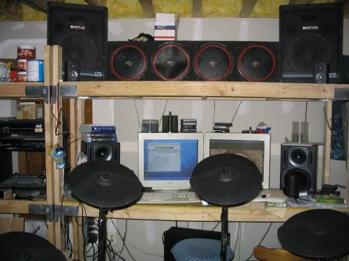

I have a 4x12 cab loaded up with car subs in my pa.. They sounded boomier in the van, but they most certainly add a lot of low end. I wired em series/parallel to 4 ohms, which gets the most out of the amp. I'm pushing em with a QSC 850 so I could probably fry em all at once if I felt like it. I have another 2x12 sub box with MTX 12's I turn on while playing my vdrums, you can feel the kick.. It works, I'm sure some subs built for the purpose would sound better, but I've always been a car audio freak, so that's what I had....

yeah, i guess i could see it for v-drums, especially for practice. however, the useful frequency response of a box like that wont be very effective for vocals (unless you are barry white).
a
True, which is why it never got taken to a gig. It has a separate out from the board, so that fader is just a huge bass knob, and I can turn it off completely with the mains blaring if I want. Those sonic 12's are weak in the bass department, and it fills in the low end. You do notice it a lot more when playing music vs. singing thru it.
