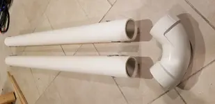

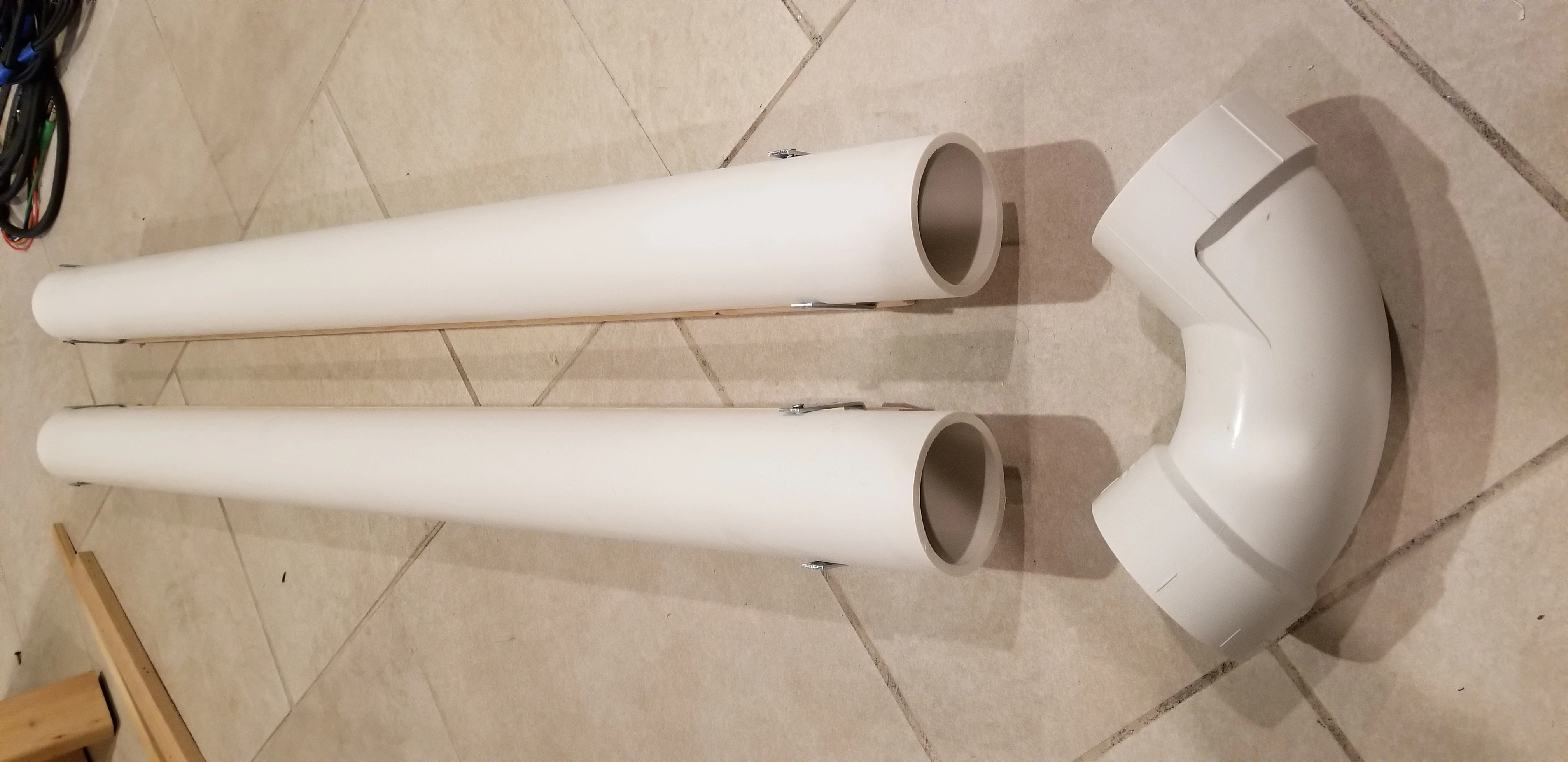

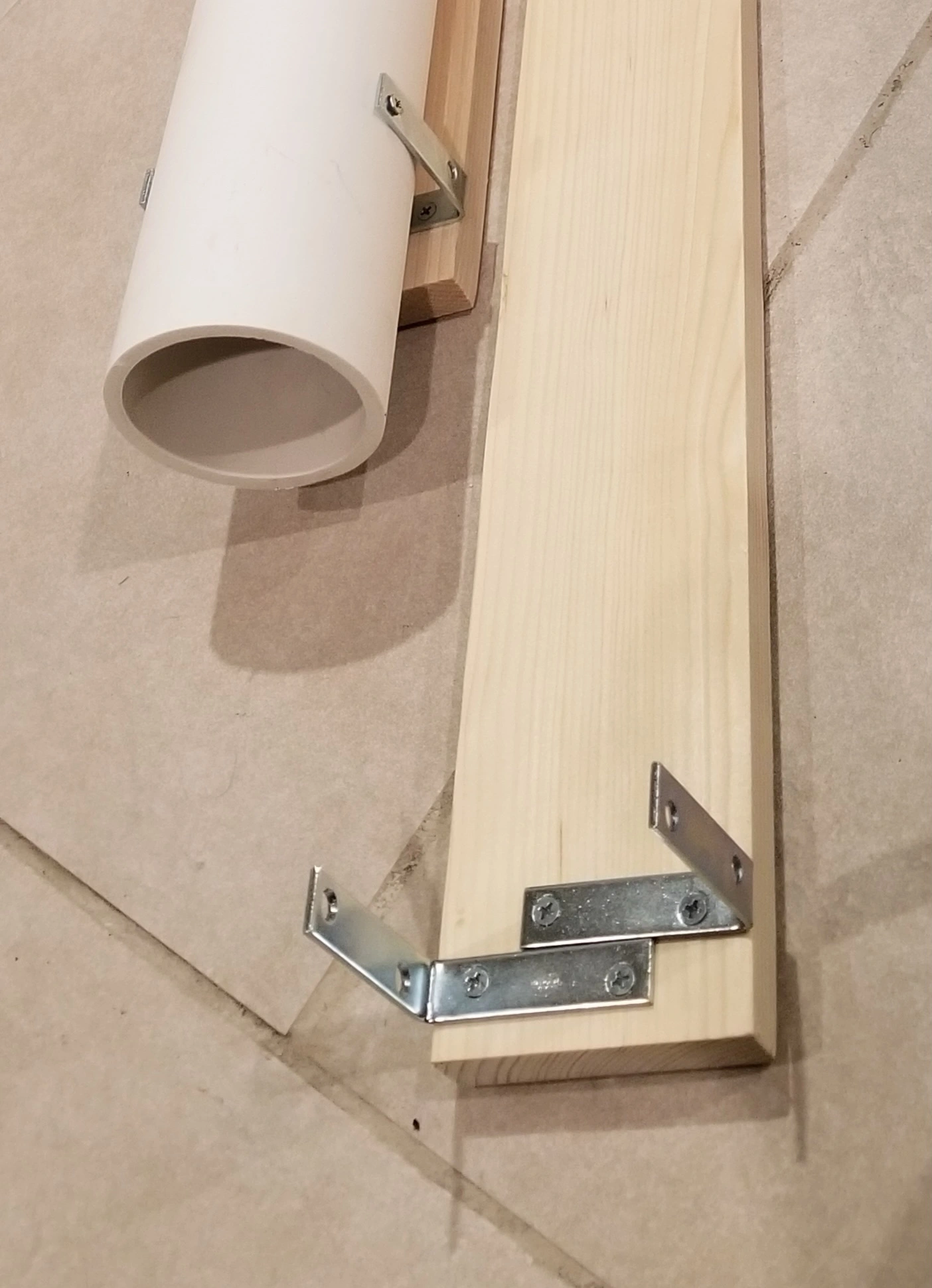

I used sections of PVC to run cables from my rack to desk.

Yes, that pipe idea looks great, can I suggest 'mini trunking' as an alternative? As well as being cheaper the cover snaps on so you can lay your cables first then cover when done. Tip: cut some ~100mm pieces of the cover to keep the wires in place then you can slide/snap the rest in when filled (after grokking of course!)
The self adhesive version is useful but the plain sort is better for some applications. Stick it with 'No Nails' or similar or just screw to a wooden surface.
Bonus! Appeals greatly to the distaff side.
