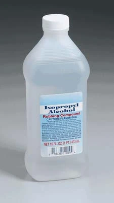

What brand alcohol do you guys clean your deck with? I am looking for +91% but they do not have the contents on the packages.
