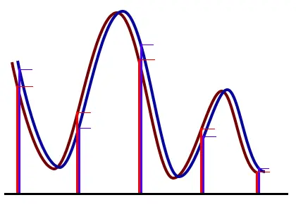

regebro said:
No, again that's based on misunderstandings. The minimum "delay" between two signals that digital can reproduce is not dependant on the samplerate. It is a function of the samplerate vs the number of levels there is in a sample. so 44*16 should be able to accurately represent a delay between two signals as short as 1/(44100*65536) second = 0.346 nanoseconds. :D
Please explain how the phase relationship is preserved between 2 signels seperated by 0.346 nS (note 0.346 nS represents a frequency of 2.98 GHz clearly about Audio range)
Please note that at a sample rate of 44.1 kHz each sample happens once every 22.68 uS. If you use 10 nS for the sample window then the value measured is integrated over that 10 nS and may or may not have settled. Once hold is triggered the signel can do anything it needs to do over the rest of the sample period, that data is lost. Let's see 22.67uS/10nS = 2267.576. So for a given signel we only look at 1/2267 part of it. It can get worse if we integrate over the entire period.
Think about having a signel that is a sub harmonic of the sample rate or near precise harmonic. (Hint, why do you think that tape bias frequency is 100 kHz or gteator?) Oh well let's save that for another time.
This calls for visual aides. :)
Se attached file. The two waves, red and blue, has a phase relationship that is WELL below the sample-rate. But as you see, because of their difference in phase, they get sampled at slightly different points in the wave, and the samples values therefore are different. When recreated, therefore, the phase relationship will be preserved. So, yet again, how small phase differences that can be preserved is not a function of samplerate, but a function of samplerate and bitdepth. (and of course, of the A/D converter, but that's implementation dependant).
