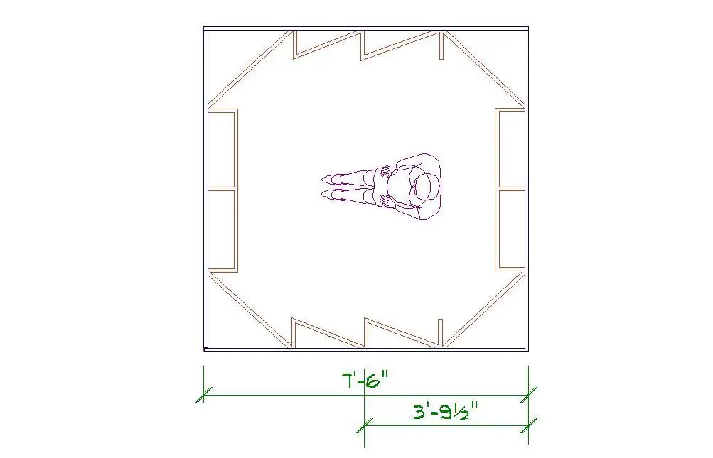

Hi guys,
Dad and I want to use John's wall units to construct a sound booth. Using that design we came up with the following attachment. The back "wall would be two pieces, one being a door.
Any advice you could give would be greatly appreciated.
What would you do for the ceiling?
Thanks,
Joe

Joe, by sound booth do you mean a vocal booth-or are you making this as a control/ mixing room?
If you have any height to work with at all, I'd make the ceiling pitched- even in any random way, it would help reduce the "squareness" of this room
Thanks Dan,
I was thinking a vocal room. The "booth" would sit inside of a larger room that has an 8' ceiling. Thats a great idea.
Thanks,
Joe
