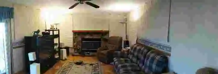

Heh he he he ! ! ! :D :D
This is some great stuff.
I'm sure this stuff works fine and all -- don't get me wrong. But did you get a load of that pic ? ?
I'm going to go waaaaay out on a limb, here, and guess that the guy who owns this living room isn't married. (?)
Can you imagine if the queer eye for the straight guy dudes came and visited this guy's place? :D Well, firtht of all, we're going to have to get rid of these billowy, fluffy blankets all over your walls and go for some softer pastel patterns.

Dude, I swear...those are moving blankets.
:rolleyes:
I use them, but you can find them cheaper than that when they're called "moving blankets" instead of "audimute".
