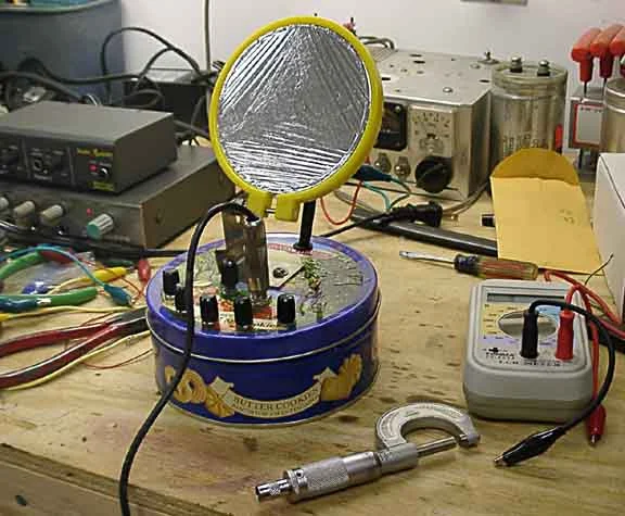

and I decided I'd use my 1000th post here to show its progress (or lack thereof) so far.
I thought I'd try to use a large diaphragm (in this case about 4 inches diameter) tuned subsonically, and try to pull off different harmonic content from different portions of the diaphragm, then mix them to the output.
This particular prototype uses 5 reflective optical sensors, one positioned centrally and the other four at different radii from there. Their outputs are mixed and sent to a mic preamp.
Major problems are:
1) diaphragm material and tensioning it. I'm using aluminum leaf reputed to be 1 micron thick. This stuff tears if you look at it wrong, and being able to tension it evenly over a ring (in this case an embroidery hoop) has been futile. If I could get some mylar or other strong but thin material of the required size this problem would be solved.
2) The sensors (LED coupled to phototransistor), not being manufactured for audio purposes, are quite noisy at the required amplification. Maybe I'll contact a manufacturer and see if they can be made as a special order to have less noise.
The mic sounds like crap of course. Maybe there's a market for a sound like someone at the bottom of a well, buried under a bunch of snakes. I can call it the hisspit mic. :)
Anyway, back to the drawing board. Any suggestions appreciated.

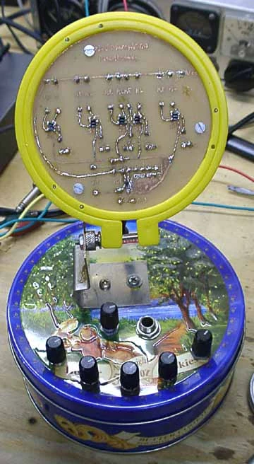

This shows the mic with membrane off. The black knobs are the pots for adjusting gain of each sensor. The middle one is the master gain.
The five small black dots horizontally across the face of the pc board are the emitter/sensors (Fairchild QRE1113).

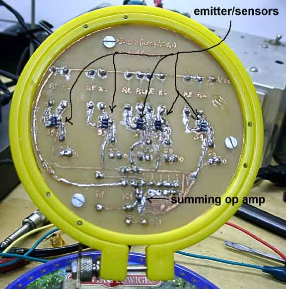

A closeup of the pc board. I put the op amp on the this board from laziness- so I wouldn't have to make another board inside the can. :)

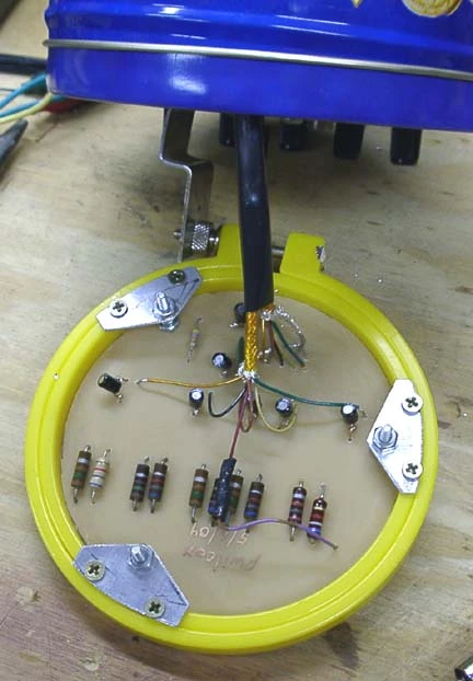

The back of the board with the non-surface mount components.
The metal triangles contain spring loaded screws to move the board closer or farther from the membrane, as an adjustment of the sensitivity of the sensors.

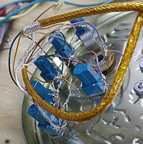

The pots and wires inside the can - not the neatest in the world, but hey, it's just a prototype.
