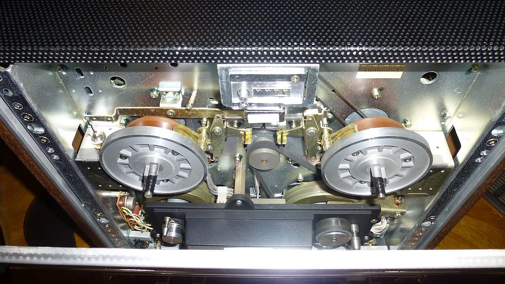

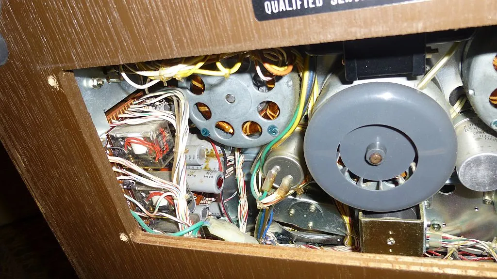

After the discussion in another thread about "analog emulation" plugins, I decided to pull the thing out and give a quick check to see what type of shape it was in. My old Dokodor has fallen into disrepair with belts melting, etc. Thankfully this thing, besides being quite hefty (45 lbs), was in pretty good shape. A couple of button caps have been knocked off their switches, but the buttons are still functional. A cursory check of the caps didn't show any bubbling up. The belts were nice and pliable. The reel and capstans turn freely.

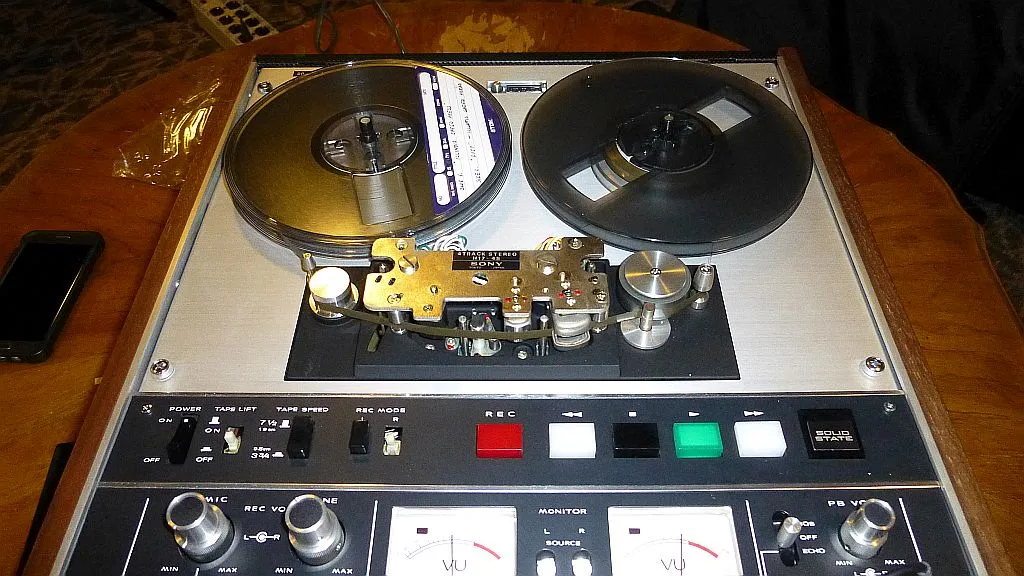

I pulled out the only reel of tape that I have left, a reel of TDK Audua with two Illinois Speed Press albums on it, threaded it on the machine and hit play. Of course, the tape is 40 years old, so the leader tape immediately pulled away from the audio tape. Luckily, I have a small spool of splicing tape that is still good, so I put things back together (on a glass plate.. don't know where my slicing block is) and hit play again.
Presto, it works.

Sweetbeats, I had to get a few drops of light oil onto the pinch roller bearing and the capstan motor. I need to check the flutter roller to make sure it's turning smoothly. I pulled the service manual down off of HiFiEngine to see if there are any other points that I need to check.

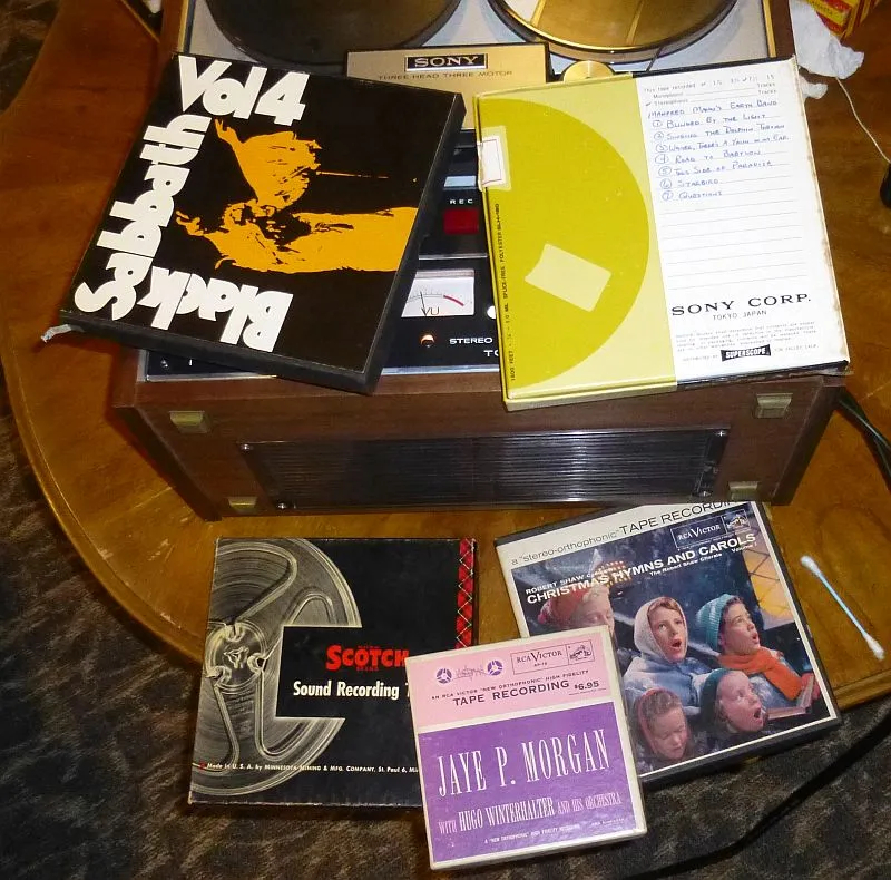

My brother dropped off a box of tapes that he had. Some of these were albums he recorded from my collection. We used to dub each other's albums back then. Black Sabbath - Sabbath Bloody Sabbath, Starcastle, White Witch, Manfred Mann's Earth Band - Roaring Silence were the first ones I checked.
Here's the kicker, I pulled up the original albums and they are on pitch. Apparently this deck might have shipped out of spec for speed. I noticed on a 3.75" recording, it was maybe 3-5% off pitch, but that was recorded on a different tape deck so maybe that was a tolerance difference. So either the oil has finally worked it's way into the bearing and loosened things up, or the speed was off for 50 years! There's a receipt for a reel of tape that is dated 1973. I'll go back to some of the prerecorded tapes and see how they are now. He's also got a prerecorded Black Sabbath 4 reel, so I'll put that on after Sabbath Bloody Sabbath finishes. (It's been years since I listened to that one).
I've also got 5 factory sealed reels of Sony SLH180 Hi Output/Low Noise tape. This was what the machine was originally set up for, so that's cool.
