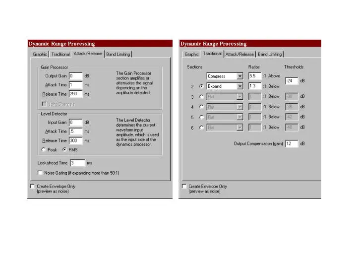

(compressor settings)
Compress 5.5:1 above -24db
Expand 1.3:1 below -24db
Gain Output = 12db
Attack of 1ms, release 250ms.
Gain Output = 12db
chrisharris, regarding these settings, are you expanding with a second plug in or does your compressor have expansion too?
My compressor does not have expansion and I would have to use a 2nd plug to do this.
Here's a pic (God, I'm lame).

Thanks for the pic Chris. This is a concept that had not occured to me before, compressing transients peaks and expanding transient dips to smooth out the vocal. This covers those quiet vocal spots where you want to create a little intimacy in the vocal but need to rein it in when things get loud.
In Sonar this would require two plug-ins, maybe, as I am not aware of any compressor plug-ins that do both.
Cool, I learned a new tip today. I love this place...
