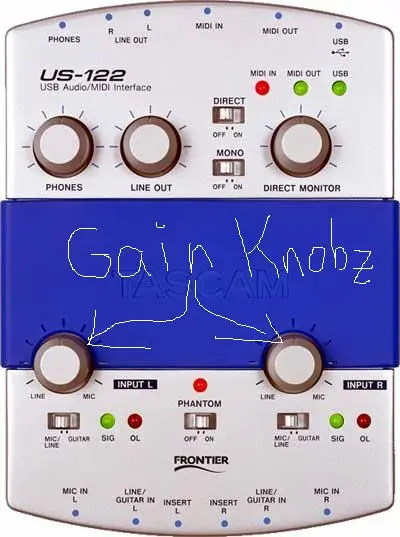

How do you set the gain on the mic preamps of the US-122? There's no gain knob that I can see in a picture.
If there is no gain control, maybe the preamps are preset for a gain compatible with a condenser mic, and then further levels are controlled with the sound card and tracking software. This would be inadequate for a dynamic or ribbon mic.
:D :D :D :D
