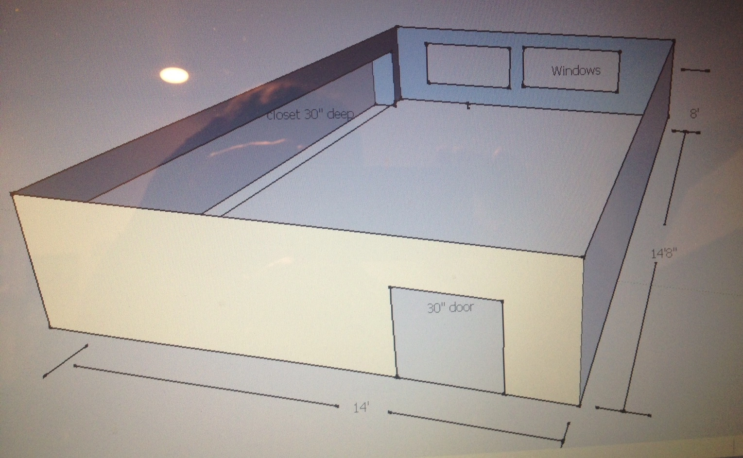

John,
Please see the room layout below.
The common wall is the one on the right. I turned on the TV and the measured 45dB C weigthed in the Studio. I could hear the dialog plainly.
The mixing desk will be centered in the room in front of the windows. I will also track in this room as well.

Any ideas on isolating this rooms common wall, other than I'm doomed and nothing will isolate the common wall.
Me thinks the best bang per buck might be to have a company provide blown in insulation.
Suggestions appreciated.
How about building a second wall with airgap between it and the existing wall? Insulate the new wall with usual pink stuff. Blown-in insulation into the exisiting wall (as well) would be beneficial. I think that's the best you're going to be able to do.

Decoupling is out of the question?
If you double the mass of the wall, you could get an additional 5 dB isolation. Again, if you were to build another wall with a couple layers of 5/8" drywall (firecode, type X), you might gain 20 or more decibels in isolation. The party wall is very long and creates a large surface (diaphragm) area which will intensify the transmission.

John,
Your suggestion and MJBPhoto's are what I was concerned with. Probably the best solution.
My consideration at this point is expense, while I'm capable of doing this myself, the costs would be relatively low. Getting the wife to approve is another matter entirely! Ha.
My other concern would be loosing more space in what is already a smallish room. I have to sus that out.
In refrence to doubling the mass, are you suggesting that hanging 2 more sheets of 5/8" over the existing sheetrock on the common wall would provide about 5dB reduction? Should I bother with blown in insulation on the common wall before I had a few layers of sheet rock?
Muddy,
Normally I would not recommend blown-in cellulose fiber insulation, however for coupled or standard partitions this type of insulation will have a damping/mass effect similar to sand. (In decoupled partitions this is NOT recommended.)
Therefore the increase in STL would probably be in the range of at least an 8 dB gain. This is something worth doing.. THAT in addition to Green Glue damping between the added sheets of 5/8".
So, if you go the blow-in route, add 2 layers of 5/8", fire-rated (type X) drywall, and Green Glue between layers, you may very well add 15 dB STL - which is nothing to sniff at. - All that for a loss of 1 1/4 inches.

And add a second wall, spaced maybe 4" off the existing wall, 2x4, with 2 layers of 5/8 on it, for a total of 12" lost to the room - making it 13' x 14'8" - a little less 'square' than you had could not hurt either.
