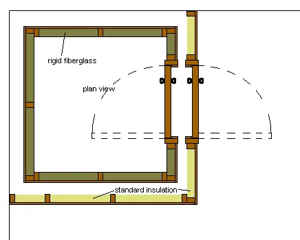

Hey. Ok, so do you need isolation within the room, or just from your parents? What is the wall like separating you from your parents?
What you want is as much mass as possible in a MAM(mass-air-mass) structure(the existing wall can act was one of the mass, if you don't need much isolation within the room). The inner mass should be decoupled from the outer, meaning no flanking path for noise. This means building a floating floor(mdf/plyboard on rubber sheeting), and building the walls on top of that, not touching anything else.
Square, and especially cube, rooms are not ideal for room acoustics, so stay away from this if possible, although for ease of building and budget for materials 4'x4'x8' is probably best.
If you need isolation within the room, then you will need to build a two leaf structure. This can be done by placing the booth(that i will suggest) in the corner, and building another leaf round it(see picture below).
If you don't need isolation within the room, only from the rest of the house/neighbours, then check out my suggestion/step-by-step building guide over at the portable vocal booth thread. This should give you all the info you need to know about building a booth. :D

Hardwood flooring is great in studios. Keep it and add absorption(rigid fiberglass panels, do a search) to your walls/ceiling.
Egg crate does almost nothing, and anything it does is only at the highest frequencies.
I think, if you don't need isolation within the room, that a 1 leaf structure should be fine, with the second leaf achieved from the existing walls. To dampen the reflections, you need acoustic treatment(absorption), which is a totally different ball-game to isolation. In my booth suggestion, the absorption is done by the 4" rigid fiberglass.
Again, do a little search in this forum, and you will find answers to your questions. For isolation you need mass, and airtight seals. Mass can be achieved with drywall, MDF, plyboard etc. Seals with caulk, silicone, rubber door seals, etc. For acoustics, absorption and diffusion. Absorption, in the context of a recording studio, can be achieved through the use of proper acoustics foam and rigid fiberglass. Diffusion, with correctly designed and manufactured diffusors, like this.

That's a great booth, but firstly, i doubt you need the staggered stud wall, if the isolation is only for people outside/the rest of the house, and there is an existing wall. 1 leaf should do. And secondly, his absorption is way too thin, which means, there will definitely be bass problems in that booth, especially since it is so small, you're basically in all the corners.
