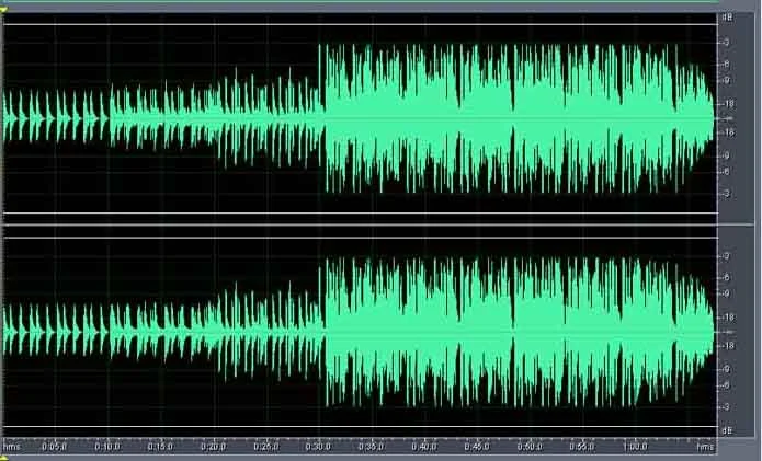

Ok I was using WAVE's L2 plugins to sorta master my track the other night....But I didnt know how high on db I wanted the wav to be at the finish...so my question is....looking at the screenshot below is that right?? or do i need to boost it to the white line?
Also if you see anything else wrong please tell me....
Thank You

It doesn't matter what it looks like, just what it sounds like. You don't look like you have completly screwed youself with it, I would leave it there.
You can't go over the white line, it won't let you. Set the output of the L2 to -.3db and set the other fader so that the reduction meter doesn't read any more than -4db. That is about the safest setting I can think of.
BTW The point of a limiter like this is to makes sure you don't go over, there is no way to set this so that it does.
I just ran it and yes it still boosts the track over the white line
What white line are you talking about? It will not let you get over 0db. Anyway, stop looking at the pretty picture. That will only give you an idea of your peak volume. Precieved volume is something you can't really see on the graphic. Are your meters telling you that you are clipping.
So that white line is just for looks? cause i was wondering why when i put a commercial instrumental in there alot of times the beat went over that white line just that it wasnt clipping though....

not -3, -.3 Three tenths of a db below zero.
There is no way to clip when you are running through that limiter. go ahead and turn it up until it starts to sound like crap, then back it off.
yea i did do -.3 but see at first i thought that white line represented 0 db and over that meant clipping...see i was wrong wasnt i? lol so when i listen to my track as long as it doesnt go over the 0 on that meter picture i showed then i should be fine right?

On the clipping - As mentioned, the "appearance" is relatively unimportant. By looking at it, it "looks" like it was limited hard. Whether it sounds like that or not may be another story. A limited sample, while not technically an over or clip, still represents dynamics that are gone. And digital limiters in general just don't do with the "style" as a good analog unit (IMHO, YMMV, etc.). Also true, analog limited tracks (IME, anyway) "look" (and sound) less smashed than their "skating rink flat" digital counterparts.
